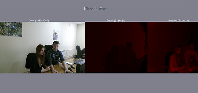

kinect_00 Sample that shows Kinect buffers: color, depth, and IR rangekinect_00 显示 Kinect 缓冲区的示例:颜色、深度和 IR 范围
