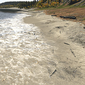

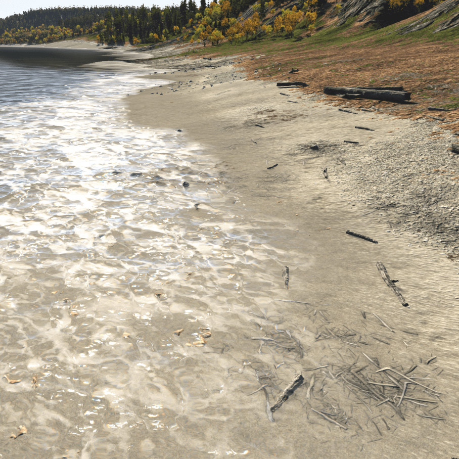

The World Clutter node allows scattering a set of identical nodes (node references) randomly across the scene practically in one click. There is no need any longer to position, scale, and rotate every single object by hand and constantly mind the performance factor. World Clutter automatically places nodes in the scene with random parameters, all of which can be efficiently controlled, and renders them only around the camera. World Clutter is used to scatter non-geometry objects, such as decals, particles systems, and so on. But if you want to scatter identical meshes, it is better to use Mesh Clutter.World Clutter节点实际上允许一次单击即可在场景中随机散布一组相同的节点(node references)。不再需要手动定位,缩放和旋转每个单个对象,而始终关注性能因素。 World Clutter会自动将具有随机参数的节点放置在场景中,所有这些参数都可以得到有效控制,并且仅在摄影机周围渲染它们。 World Clutter用于分散非几何对象,例如贴花,粒子系统等。但是,如果要散布相同的网格,最好使用Mesh Clutter
World Clutter scatters objects procedurally and therefore even more memory-efficient. At the same time it means that scattered objects cannot be moved.World Clutter会按程序分散对象,从而提高内存效率。同时,这意味着无法移动分散的对象。

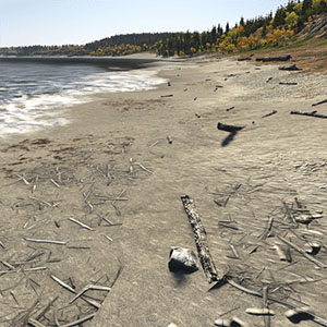

World Clutter uses only Reference Nodes, because when the world is loaded they are scattered around the camera much faster.World Clutter仅使用参考节点,因为加载世界时,它们散布在相机周围的速度更快。

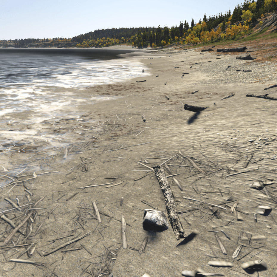

Scattered wood chips created using World Clutter使用World Clutter创建的散落木屑

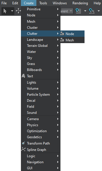

To create World Clutter, do the following:要创建World Clutter,请执行以下操作:
  1. Add a World Clutter node: in the Menu, choose Create -> Clutter -> Node.添加一个World Clutter节点:菜单,选择Create -> Clutter -> Node
  2. Locate World Clutter on the scene.在现场找到World Clutter

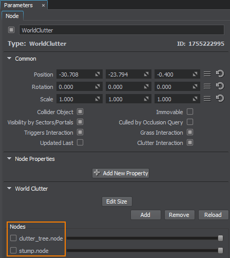

Objects in World Clutter are node references that are scattered throughout a definite area and for each of which the probability of its appearing is controlled.World Clutter中的对象是node references,这些对象散布在确定的区域中,并针对每个对象控制其出现的可能性。
Node references that are contained in the clutter
List of node references in World ClutterWorld Clutter中的节点引用列表

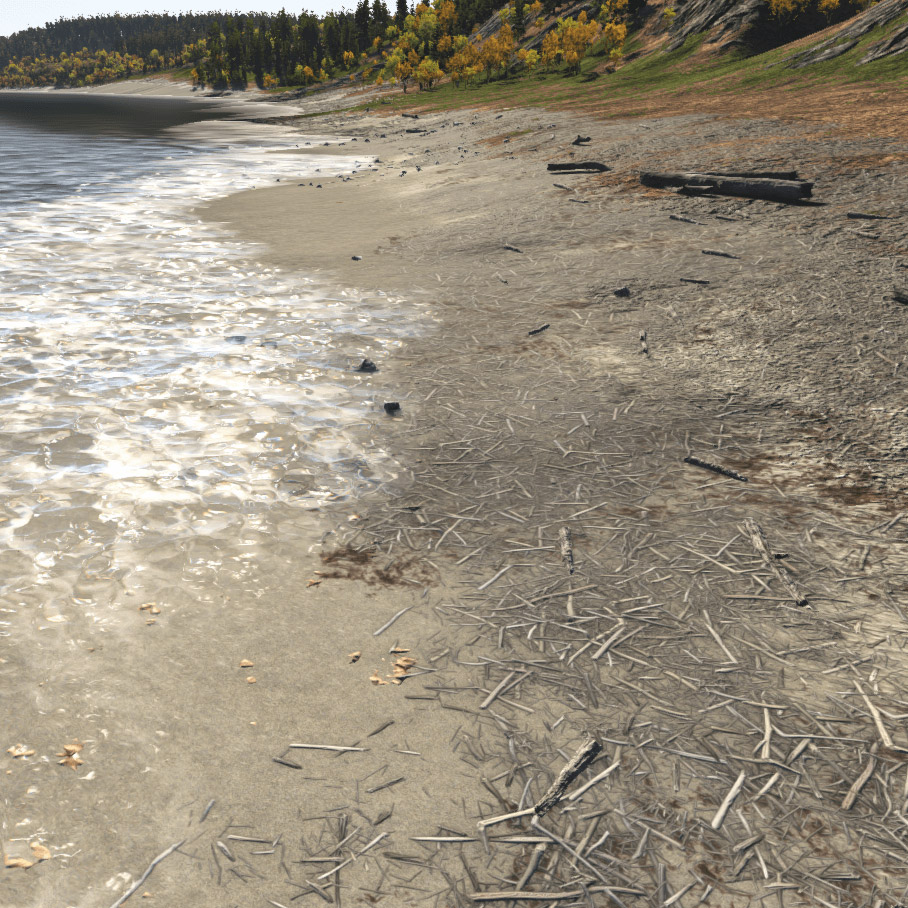

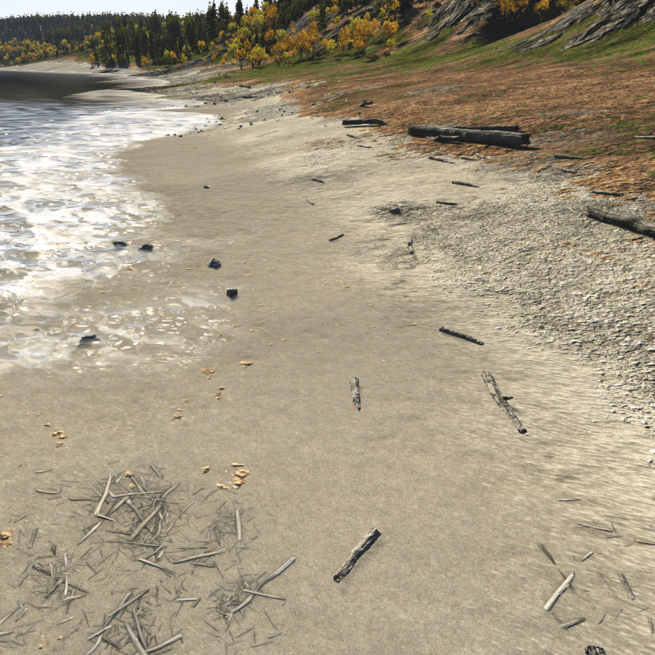

Density

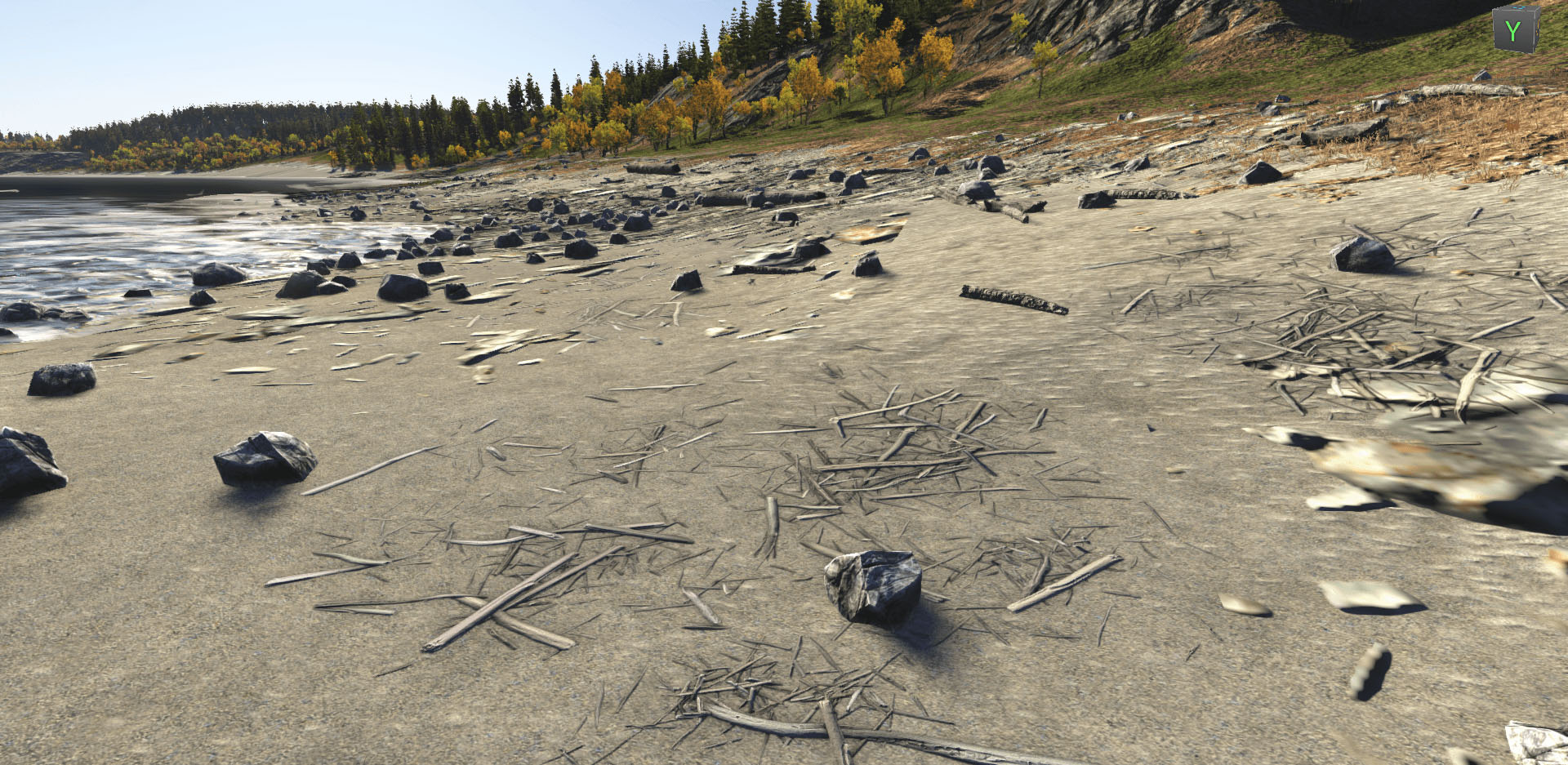

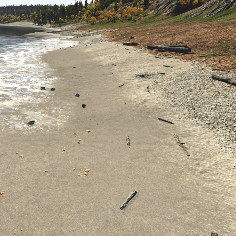

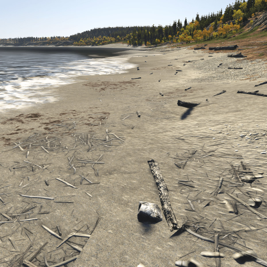

Density specifies how many objects there are per square unit. In case there is more than one object in World Clutter, probability will be taken into account, but will not change the resulting number of all rendered objects.密度指定每平方单位有多少个对象。如果World Clutter中有多个对象,可能性将被考虑在内,但不会更改所有渲染对象的结果数量。
If the density value is too high, objects can be penetrating each other.如果密度值太高,则物体可能会相互穿透。
Lower Density
Lower Density较低的密度
Higher Density
Higher Density更高的密度

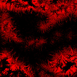

Image Mask
Areas across which the objects are randomly scattered and areas without any objects from the list. For example, on the terrain, a mask allows to scatter debris across certain areas, while leaving other places free of it.对象随机散布的区域以及列表中没有任何对象的区域。例如,在地形上,面罩允许将碎屑散布到某些区域,而其他地方则没有空间。
When the image mask is not set, the default mask with maximum mask values will be used. The maximum mask value is 255.未设置图像蒙版时,将使用具有最大蒙版值的默认蒙版。 最大掩码值为255
  • The mask is one-channel texture (R8). If there are more channels in the provided mask, they will be ignored.蒙版是单通道纹理(R8)。如果提供的掩码中有更多通道,则将忽略它们。
    • Zero color value specify the areas without World Clutter objects.Zero颜色值指定不包含World Clutter对象的区域。
    • The higher the color value is, the more objects there are in this area and the denser they are positioned.颜色值越高,该区域中存在的对象越多,并且放置的对象越密集。
    • Color value of 255 means the density is as specified in by the corresponding parameter.颜色值255表示密度如对应参数
  • Masking is done for all objects that are contained in World Clutter list.World Clutter列表中包含的所有对象进行屏蔽。
World Clutter mask for scattering
To paint the image mask directly in the scene, use Mask Editor.要直接在场景中绘制图像蒙版,请使用Mask Editor
