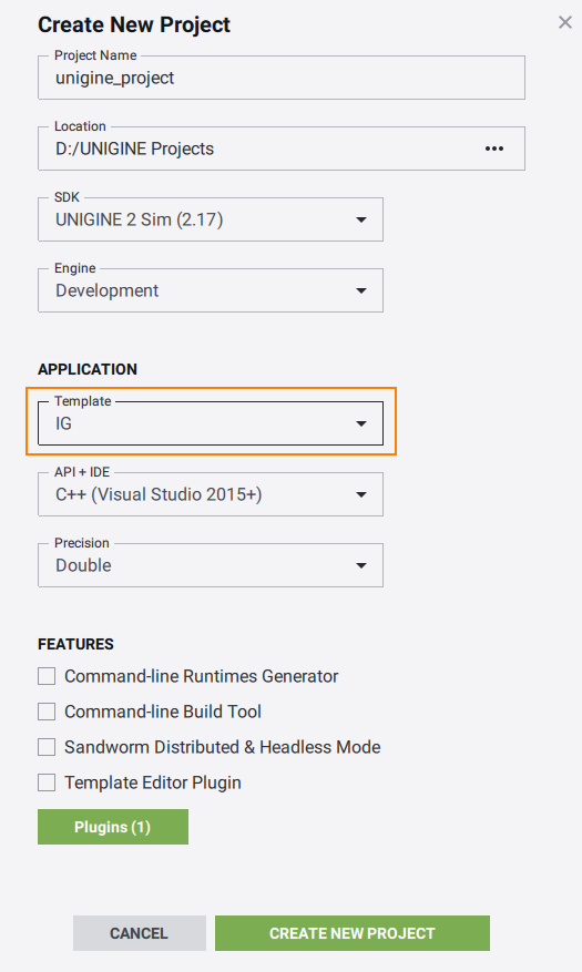

  1. Create a new project using the IG Template as described here.使用IG Template和创建一个新项目组件系统如前所述这里
    Create a Project using the IG Template and Component System

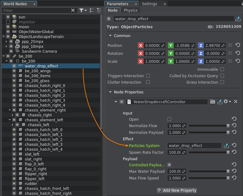

    In the header file (WaterDropAircraftController.h) define the name for the property file and describe parameters of the component:在头文件(WaterDropAircraftController.h)中定义属性文件的名称并描述组件的参数:
    源代码 (C++)
    // WaterDropAircraftController.h
        // Specifying the name of the property file and parameters for our component
        PROP_NAME("WaterDropAircraftController");
        PROP_PARAM(Toggle, open, false, "Open", "Input parameter for enabling/disabling the effect", "Input");
    	PROP_PARAM(Float, normalize_flow, 1.0f, "Normalize Flow", "Input parameter for the effect power normalization", "Input");
    In the implementation file (WaterDropAircraftController.cpp) write your component's logic. At the initialization stage subscribe to parameter change event, as this component (property) will be associated with IG components changing these parameters when receiving commands from a host.在实现文件(WaterDropAircraftController.cpp)中,编写组件的逻辑。在初始化阶段,请订阅参数更改事件,因为当从主机接收命令时,此组件(属性)将与IG组件关联,这些IG组件会更改这些参数。

  5. Via the UNIGINE Editor, assign the new created property file (WaterDropAircraftController.prop) to a node, for which the component was created (Be-200 in our case).通过UnigineEditor,将新创建的属性文件(WaterDropAircraftController.prop)分配给为其创建组件的节点(在本例中为Be-200)。
    Create a Particle System in the UNIGINE Editor and set its parameters as required. Add this Particle System to the corresponding field of the property.创建一个粒子系统在UnigineEditor中,并根据需要设置其参数。将此粒子系统添加到属性的相应字段。
