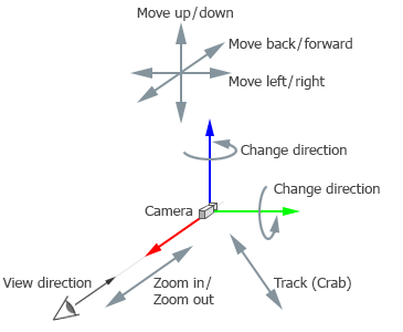

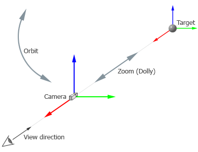

The following schemes demonstrate the main navigation controls that are used in UnigineEditor:以下方案演示了 UnigineEditor 中使用的主要导航控件:
Navigation controls used to freely move the camera in the scene用于在场景中自由移动相机的导航控件
Additional navigation controls used to move the camera relative to the target用于相对于目标移动相机的附加导航控件

If you focus the camera on the node (or the group of nodes), the target position will coincide with the center of the node (or the group of nodes). Therefore, you will be able to orbit the camera around this target and zoom (dolly) the camera towards or away from this target.如果将相机聚焦在节点(或节点组)上,则目标位置将与节点(或节点组)的中心重合。因此,您将能够轨道这个目标周围的相机和变焦(小车)相机朝向或远离该目标。

To move in the scene, you can use the following default controls:要在场景中移动,您可以使用以下默认控件:
Control Description
RIGHT-CLICK + Drag
Change the camera direction.改变相机方向。
  • Press and hold this key and drag the mouse left or right to change the yaw angle. In this case, the camera will rotate around its vertical axis.按住此键并向左或向右拖动鼠标可更改偏航角。在这种情况下,相机将围绕其垂直轴旋转。
  • Press and hold this key and drag the mouse up or down to change the pitch angle. In this case, the camera will rotate around its horizontal axis.按住此键并向上或向下拖动鼠标可更改俯仰角。在这种情况下,相机将围绕其水平轴旋转。
RIGHT-CLICK + W Move the camera forward.向前移动相机。
RIGHT-CLICK + S Move the camera backward.向后移动相机。
RIGHT-CLICK + A Move the camera left.将相机向左移动。
RIGHT-CLICK + D Move the camera right.向右移动相机。
RIGHT-CLICK + Q Move the camera down.向下移动相机。
RIGHT-CLICK + E Move the camera up.向上移动相机。
Alt + MIDDLE CLICK + Drag Alt + 中间点击 + 拖动 Track (crab) the camera in the plane which is perpendicular to the view direction.在垂直于视图方向的平面中跟踪(捕获)相机。
Alt + LEFT CLICK + Drag Alt + 左键单击 + 拖动 Orbit the camera about the target.围绕目标旋转相机。

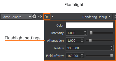

Flashlight Settings手电筒设置
Control Description
L Toggle a flashlight attached to the camera.切换连接到相机的手电筒。
Flashlight Settings
手电筒设置#
Color A flashlight color.一种手电筒颜色。
Intensity A flashlight color intensity. The higher the value, the brighter the light is.手电筒颜色强度。值越高,光线越亮。
Attenuation A flashlight attenuation power. It simulates light intensity gradual fading.一个手电衰减功率。它模拟光强度逐渐衰减。
Radius A radius of the area illuminated by the flashlight.手电筒照射区域的半径。
Field of View A field of view of the flashlight. This parameter defines the angle of the light clipping in range from 10 to 160 degrees.手电筒的视野。该参数定义了范围从 10160 度的光剪裁角度。

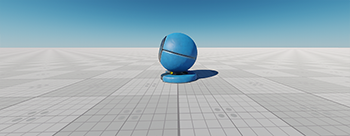

The following pictures show 2 cameras positioned in different points in the world:下图显示了位于世界不同地点的 2 个摄像头:
camera_0 camera used as watch-pointcamera_0 相机用作观察点
camera_0 camera viewcamera_0 相机视图

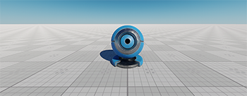

camera_1 camera used as watch-pointcamera_1 相机用作观察点
camera_1 camera viewcamera_1 相机视图
