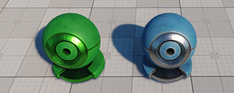

This class implements pseudo-random number generation functions for various purposes. A 32-bit seed value is used, upon creation an instance is initialized with a seed value equal to the current time. In case two instances of Random are created with the same seed, and the same sequence of method calls is made for each, they will generate and return identical sequences of numbers. Therefore, if you have a component using its own internal Random member (e.g., to move a node in a random direction, see code below), the sequence of numbers generated for different nodes having this component assigned will likely be the same resulting in all nodes moving together in one direction.
RandomMovement.h (C++)
#pragma once
#include <UnigineMathLibRandom.h>
class RandomMovement : public Unigine::ComponentBase
	COMPONENT_DEFINE(RandomMovement, Unigine::ComponentBase);
	COMPONENT_UPDATE(update);
	PROP_PARAM(Float, speed, 2.0f, "Speed");	// movement speed
	Unigine::Math::Random rnd;	// internal random generator
	void update();
RandomMovement.cpp (C++)
#include "RandomMovement.h"
#include <UnigineGame.h>
REGISTER_COMPONENT(RandomMovement);
void RandomMovement::update()
	// making a direction vector using random values (vary for different nodes having the component assigned)
	vec3 dir = vec3(rnd.getInt(-1, 2), rnd.getInt(-1, 2), 0);
	vec3 p0 = node->getWorldPosition();
	vec3 p1 = p0 + dir * speed * Game::getIFps();
	// moving the node along the obtained direction vector with the given speed
	node->setWorldPosition(p1);

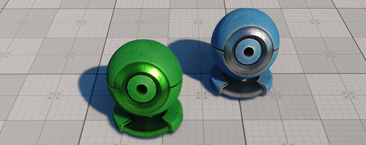

To avoid such behavior you can use similar methods of the Game class as in this case there is a single Random generator (internal Game class member) and each call to Game::getRandom*() method returns the next element of the pseudo-random number sequence.
#pragma once
	void update();
	vec3 dir = vec3(Game::getRandomInt(-1, 2), Game::getRandomInt(-1, 2), 0);
