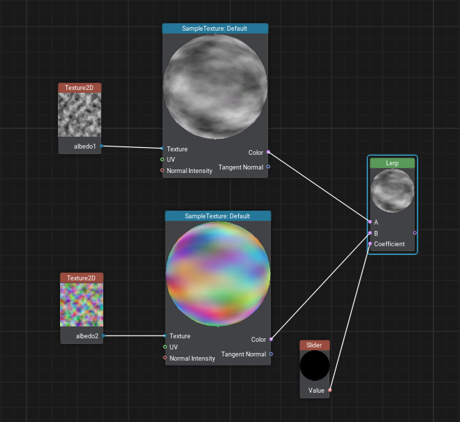

This node is used to blend (linear interpolation) between two input values or colors A and B depending on the Coefficient.
  • if Coefficient = 0 the node outputs A value
  • if Coefficient = 0.5 the node outputs a halfway blend between A and B
  • if Coefficient = 1 the node outputs B value
  • for all other Coefficient values the node outputs a linear blend of A and B
