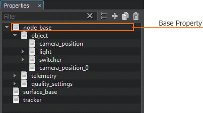

At the top of the hierarchy there are base properties. Unigine provides 2 built-in read-only base properties: node_base and surface_base. You can also make custom base properties of your own.在层次结构的顶部,有 基本属性 。 Unigine提供了2内置的只读基本属性:node_basesurface_base。您还可以创建自己的自定义基本属性。
If you need to assign a property to a single surface, it is recommended to inherit it from the surface_base property.
It is also recommended to inherit properties that will be assigned to nodes from the node_base property. However, you can also assign any custom base property or its children to a node.

Base properties cannot have a parent: no base property can be inherited from another base property. The values of parameters of manual properties (including base ones) cannot be changed. So, to modify parameters of a manual property via the UnigineEditor, you should inherit a user property from it. 基础属性不能具有父级:不能从其他基础属性继承基础属性。 手动属性 (包括基本属性)的参数值无法更改。因此,要通过UnigineEditor修改手动属性的参数,您应该从中继承 用户属性
The parent of a user property can be changed by dragging it to a new parent in the Properties Hierarchy window.可以通过将用户属性的父级拖动到Properties Hierarchy窗口中的新父级来进行更改。
