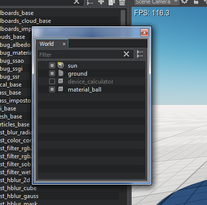

Now you can resize and place it anywhere on the desktop, e.g., on a second screen. The new window will appear always on top of the main one.现在您可以调整大小并将其放置在桌面上的任何位置,例如,第二个屏幕上。新窗口将始终显示在主窗口的顶部。
The separate window looks as follows:单独的窗口如下所示:

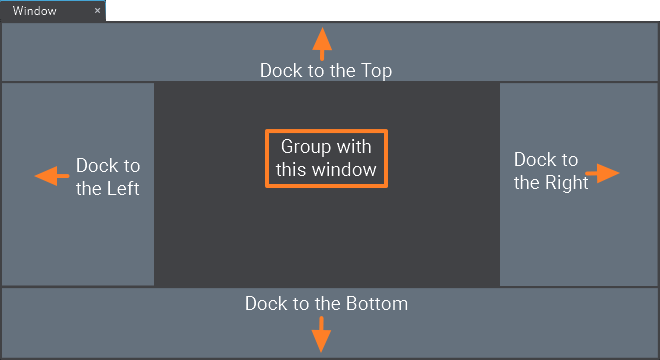

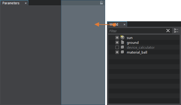

To dock a window, detach and drag it to one of the following areas of the target window shown on the picture below until the docking option will appear:要停靠一个窗口,请将其分离并拖动到下图所示的目标窗口的以下区域之一,直到出现停靠选项:
The picture below shows the highlighted option of docking to the right side:下图显示了突出显示在右侧的对接选项:

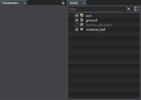

  • Docking to the side splits the window to two panels as shown below: 停靠在侧面将窗口分成两个面板,如下所示:
    You can change size of panels by dragging their borders.您可以通过拖动面板的边框来更改面板的大小。

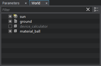

  • Grouping unites the windows as tabs inside a common panel: 分组将窗口合并为一个通用面板中的选项卡

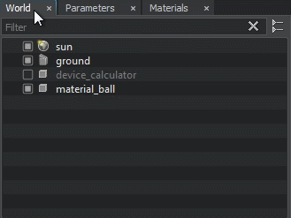

To arrange a group of tabs simply click the tab title and slightly drag it horizontally without detaching.要排列一组选项卡,只需单击选项卡标题,然后将其略微水平拖动即可不分离。
