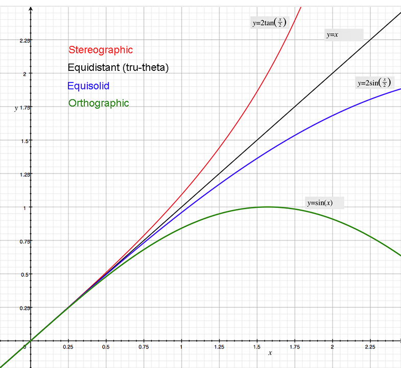

  • Equidistant (tru-theta or f-theta) fisheye panorama with an adjustable field of view等距(tru-theta或f-theta)鱼眼全景,视野可调
  • Stereographic fisheye panorama with an adjustable field of view具有可调整视场的立体鱼眼镜头全景
  • Equisolid (equal-area) fisheye panorama with an adjustable field of view可调视场的Equisolid(等面积)鱼眼全景
The horizontal axis on the chart above is the angle (radians) of incident light on the lens where 0 degrees is along the lens axis. The vertical axis is proportional to the radius on the fisheye image where that light exits the lens.上表中的水平轴是镜头上入射光的角度(弧度),沿镜头轴为0度。垂直轴与鱼眼图像上光线从透镜出射的半径成比例。

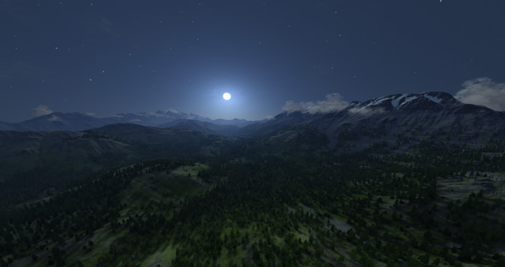

Curved Panorama
弯曲的全景#
Curved Panorama
180 degree panorama with curved edges on 1 monitor1个监视器上具有弯曲边缘的180度全景

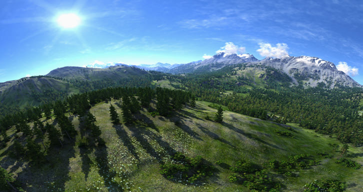

Linear Panorama
线性全景#
Linear Panorama
180 degree linear panorama on 1 monitor1个监视器上的180度线性全景

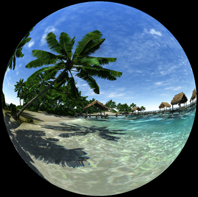

Fisheye
鱼眼#
Fisheye
180 degree spherical panorama180度球形全景

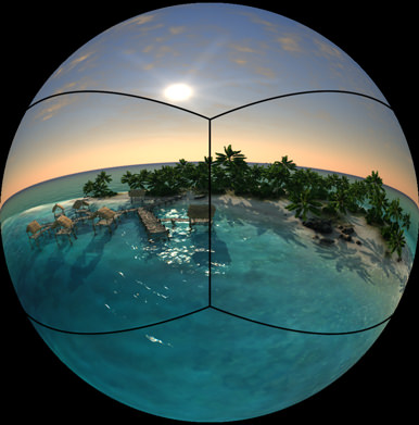

During panoramic rendering 4 viewports are seamlessly stitched into one for extra-wide field of view. Images are overlapped and blended along the border shown below.在全景渲染期间,将4个视口无缝缝合到一个视口中以实现超宽视场。图像沿如下所示的边界重叠和融合。
4 viewports of panorama
4 viewports used to render panorama用于渲染全景图的4个视口

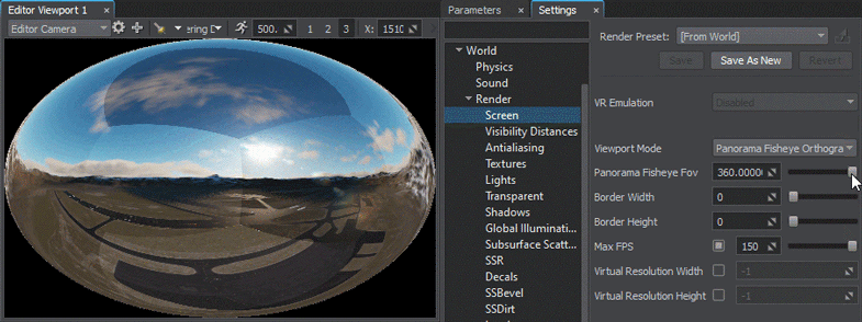

When panoramic rendering is enabled, the camera's Field of View option is not applicable.启用全景渲染时,相机的Field of View选项不适用。
To adjust FOV for fisheye panoramic rendering modes, select one of the Fisheye modes and set the desired Panorama Fisheye FOV via the Screen Settings or using the corresponding console commands:要为鱼眼全景渲染模式调整FOV,请选择Fisheye模式之一,然后通过Screen Settings或使用相应的控制台命令设置所需的Panorama Fisheye FOV
源代码
Unigine~# render_viewport_mode 7 render_panorama_fisheye_fov 30
Available only when render_viewport_mode is set to one of the fisheye panorama modes (5-8).仅在将render_viewport_mode设置为鱼眼全景模式(5-8)之一时可用。

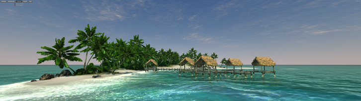

Multi-Monitor Mode
多显示器模式#
It is also possible to span panorama across several identical monitors (only) in the fullscreen mode without decorations. For that, you need to specify on the start-up:也可以在没有装饰的情况下以全屏模式将全景图跨过几个相同的监视器(仅)。为此,您需要在启动时指定:
  • The summed resolution of two displays (for example, for two 1280x1024 displays, that would be 2560x1024)两个显示器的总分辨率(例如,对于两个1280x1024显示器,则为2560x1024)
  • video_fullscreen 2video_fullscreen 2
For example (do not forget to specify other required start-up options):例如(不要忘记指定其他必填项启动选项):
命令行
main_x64.exe -video_mode -1 -video_width 2560 -video_height 1024 -video_fullscreen 2
