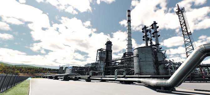

Infinite Light distance
Light Distance = inf Light Distance = inf

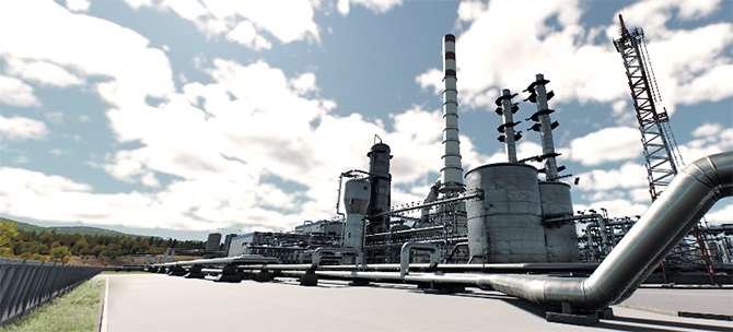

Limited Light distance
Light Distance = 20 units Light Distance = 20个单位
