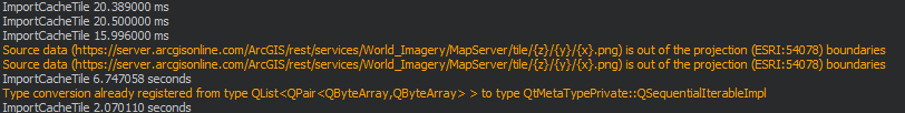

  • Open the Editor console (Windows -> Console). If something goes wrong, a console message might be useful in explaining the situation.打开编辑器控制台 (Windows -> Console)。如果出现问题,控制台消息可能有助于解释情况。
    Console errors
    Example of console errors控制台错误示例

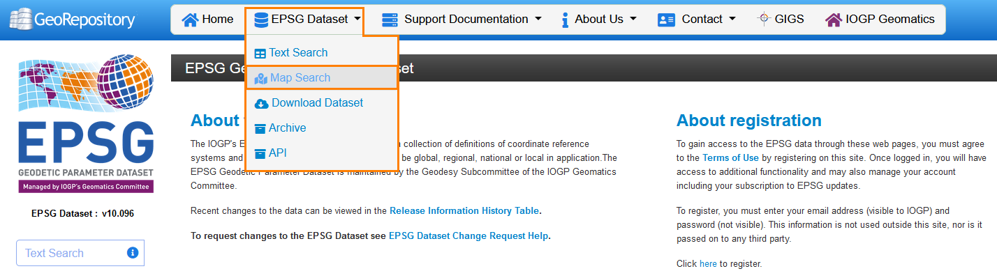

How to use https://epsg.org/:如何使用https://epsg.org/:
  1. Go to EPSG Dataset -> Map Search:转到 EPSG Dataset -> Map Search:
    If the website doesn't display any map, consider disabling adblock or using a VPN.果网站不显示任何地图,考虑禁用广告屏蔽或使用VPN。
  2. Set the area boundaries and click Search. You’ll receive a table — sort it by type (click on the TYPE heading) and select one of the data sources that is marked as Projected.设置区域边界并单击 Search。您将收到一个表格,按类型对其进行排序(单击 TYPE 标题)并选择一个标记为 Projected 的数据源。
Again, for a start, you can use EPSG:3857 — this is a projection widely used by such services as Google, OpenStreetMap, Navitel, etc.同样,首先,您可以使用 EPSG:3857 — 这是 Google, OpenStreetMap, Navitel 等服务广泛使用的投影。

Check that the output projection is set correctly.检查输出投影设置是否正确。
If the data is outside the selected output projection, it won’t be used for the terrain generation — only the part that is inside will be generated. The corresponding message will be also shown in the Editor console.如果数据在所选输出投影之外,则不会用于地形生成 - 只会生成位于内部的部分。相应的消息也将显示在编辑器控制台中。

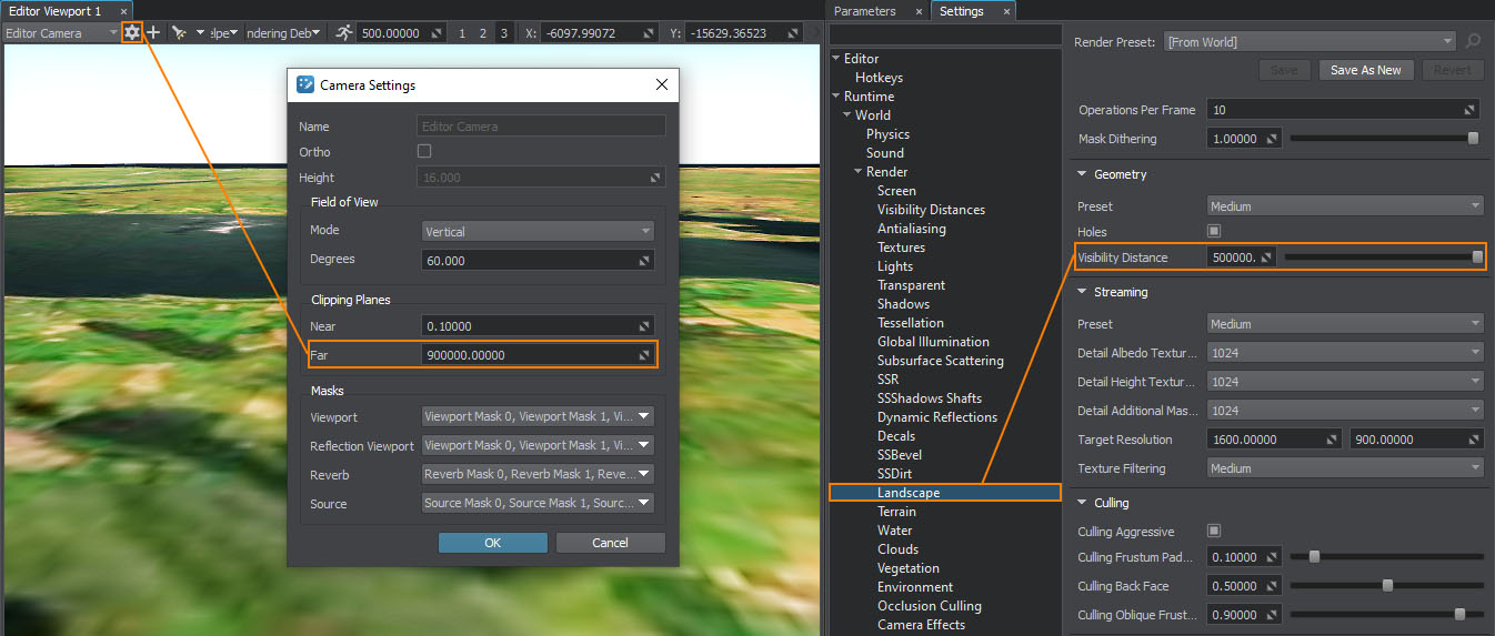

Only a part of the generated terrain is visible in the viewport.只有一部分生成的地形在视口中可见。
Change the camera visibility distance: in the Editor window, click the gear icon for the selected camera and increase the Far value. You can set the maximum, which is 900000.更改相机可见距离:在编辑器窗口中,单击所选相机的齿轮图标并增加 Far 值。您可以设置最大值,即 900000
Adjust the visibility distance for ObjectLandscapeTerrain. It is set in the Editor settings: Windows -> Settings -> Landscape -> Visibility Distance. You can set it to inf.调整 ObjectLandscapeTerrain 的可见距离。它在编辑器设置中设置:Windows -> Settings -> Landscape -> Visibility Distance。您可以将其设置为 inf
设置 Landscape Terrain 的可见距离

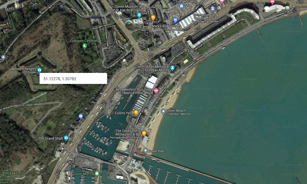

How to position an object using its geo coordinates?如何使用地理坐标定位对象?
For ObjectTerrainGlobal, you can use Geodetic Pivot in the Editor — every object added as its child can be positioned on the terrain using geographical coordinates set in latitude/longitude.对于 ObjectTerrainGlobal,您可以在编辑器中使用 Geodetic Pivot — 作为其子对象添加的每个对象都可以使用在 latitude/longitude. 中设置的地理坐标定位在地形上
As for ObjectLandscapeTerrain, the positioning tool is still in development, meanwhile you can transform coordinates using third-party sources, such as https://products.aspose.app/gis/transformation.至于ObjectLandscapeTerrain,定位工具还在开发中,同时可以使用第三方源转换坐标,比如https://products.aspose.app/gis/transformation 。
Here is a description of the workflow:以下是工作流程的说明:
  • Transform the object and the origin coordinates to the world coordinates (mind the input and output projections).将对象和原点坐标转换为世界坐标(注意输入和输出投影)。

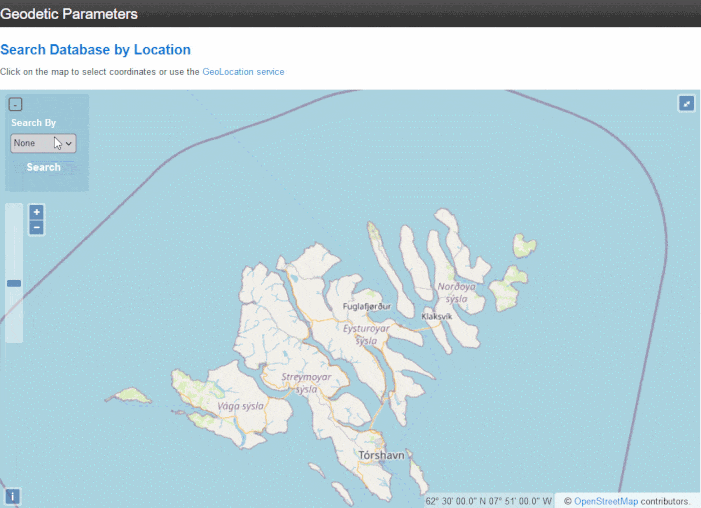

    对象的源坐标
    Source coordinates of the object (screen capture from Google Maps)对象的源坐标(来自谷歌地图的屏幕截图)

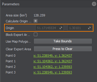

    原点的源坐标
    Source coordinates of the origin (Export Area parameter in Sandworm)原点的源坐标(Sandworm 中的导出区域参数)

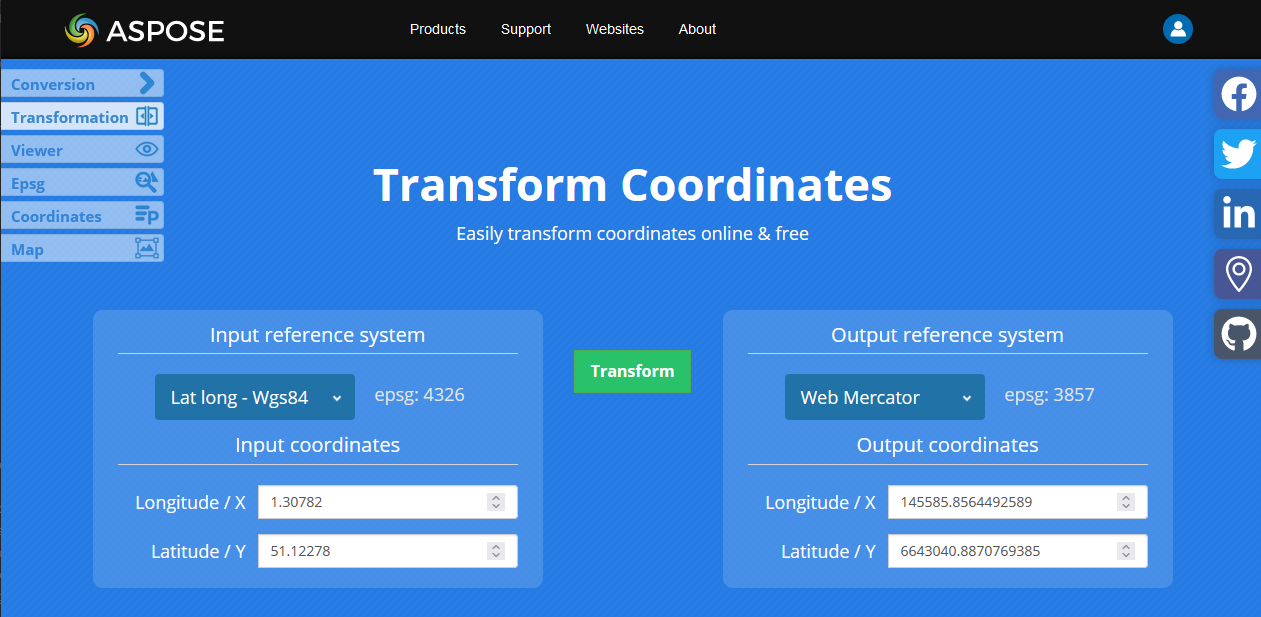

    使用 aspose.app 变换坐标
    Transforming coordinates using aspose.app使用 aspose.app 变换坐标

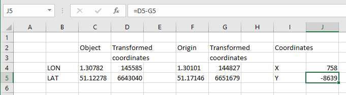

  • Take the origin position from the object position: Object.X — Origin.X; Object.Y — Origin.Y.从物体位置取原点位置:Object.X — Origin.X; Object.Y — Origin.Y
    计算场景(世界)中的坐标
    Calculating the world coordinates计算场景(世界)中的坐标

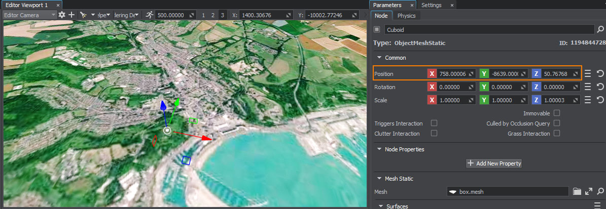

  • Use the outcome as the X and Y coordinates of the object in the world.将结果用作世界中对象的 X 和 Y 坐标。
    对象定位在世界上
    Object positioned in the world对象定位在世界上
