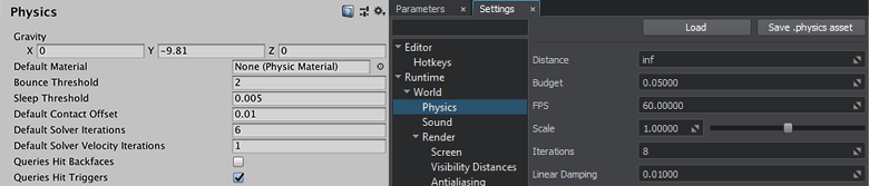

Global Physics settings, such as the global gravity vector and quality, are available in the Settings window compared to the Unity Physics section of the Project Settings:全局物理设置与“项目设置”Unity Physics部分相比,Settings窗口中提供了诸如全局重力矢量和质量之类的信息:

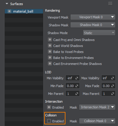

    To make a mesh surface (e.g. of an ObjectMeshStatic) provide static collisions, just enable the Collision flag for it:要使网格表面(例如ObjectMeshStatic的表面)提供静态碰撞,只需为其启用Collision标志:
    Thus, you can really quickly enable collisions with the scene geometry, however, this method may be more performance consuming than the other one, especially if the world contains a large number of polygons.因此,您确实可以快速启用与场景几何体的碰撞,但是,这种方法可能比另一种方法消耗更多的性能,尤其是在世界包含大量多边形的情况下。

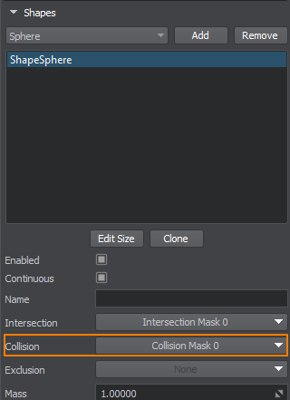

Layer-Based Collision Detection
基于层的冲突检测#
In Unity Editor, layer-based collision detection is defined by configuring the Collision Matrix in the Physics category of the Project Settings:Unity编辑器中,通过在“项目设置”Physics类别中配置“碰撞矩阵”来定义基于层的碰撞检测:

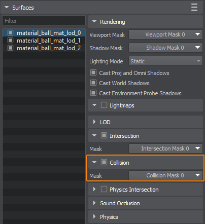

In UNIGINE, selective collision detection is controlled via Collision mask of both shapes and surfaces depending on the type of collision detection used:在UNIGINE中,根据形状和表面的Collision遮罩来控制选择性碰撞检测,具体取决于碰撞检测的类型用过的:
Shape Collision Mask
Surface Collision Mask
Two objects will collide only if their Collision masks match (one bit at least).仅当两个对象的Collision掩码匹配(至少一位)时,它们才会发生碰撞。
For more details proceed to the dedicated article:有关更多详细信息,请继续阅读专用文章:

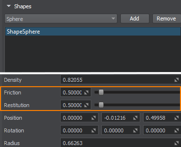

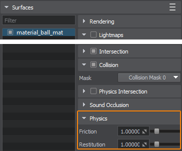

In UNIGINE, the Friction and Restitution parameters are available for shapes and surfaces and taken into account depending on the type of collision detection used:在UNIGINE中,FrictionRestitution参数可用于形状表面并根据碰撞检测的类型用过的:
