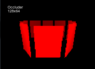

Occluder is rendered by the CPU and stored in a separate buffer. Only the Occluder nodes that are displayed in the viewport are saved to the buffer.Occluder由CPU渲染并存储在单独的缓冲区中。仅将在视口中显示的Occluder节点保存到缓冲区。
To display the buffer, you should pass 1 to the render_show_occluder console command:要显示缓冲区,您应该将1传递给render_show_occluder控制台命令:
命令行
render_show_occluder 1
The buffer will open in the upper left corner:缓冲区将在左上角打开:
Simplified Occluder that is stored in the buffer存储在缓冲区中的简化Occluder
The buffer is rendered in a low resolution.缓冲区以低分辨率呈现。
