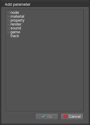

  2. Click to add a track that will animate some parameter. The Add Parameter window will open. 单击 以添加将动画某些参数的轨道。 Add Parameter 窗口将打开。
  3. Choose a parameter in the list.在列表中选择一个参数。

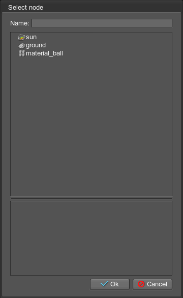

  4. If a track animates some node, material setting or a property parameter, etc., bind this track to it via the Select Node window that opens.如果轨道为某些节点、材质设置或属性参数等设置动画,请通过打开的 Select Node 窗口将此轨道绑定到它。

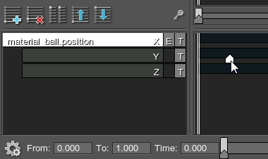

To create a key frame, click the track line:要创建关键帧,请单击轨迹线:

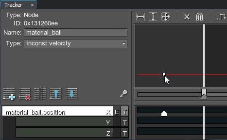

If there is a graph for the current track, you can create a key frame by clicking directly on the graph:如果当前轨道有图表,可以直接点击图表创建关键帧:

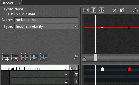

To select a single key frame, simply click it on the track line or on the graph. It will be highlighted white.要选择单个关键帧,只需在轨迹线或图形上单击它。它将突出显示为白色。

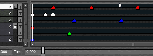

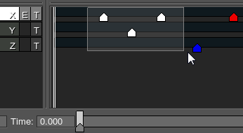

To select several key frames, use the selection box: click and hold the left mouse button, drag the mouse to select multiple key frames (either on the track line or on the graph):要选择多个关键帧, 使用选择框:单击并按住鼠标左键,拖动鼠标选择多个关键帧(在轨迹线上或在图形上):
Selecting Multiple Key Frames选择多个关键帧
Also, you can press and hold Ctrl and select the required key frames one by one.另外,您可以按住Ctrl并一一选择所需的关键帧。
Tracker supports multi-selection editing of key frames: you can select multiple keys and set Time on the track or Value for several parameters simultaneously.Tracker支持关键帧的多选编辑:您可以选择多个关键帧并在轨道上设置Time或同时为多个参数设置Value

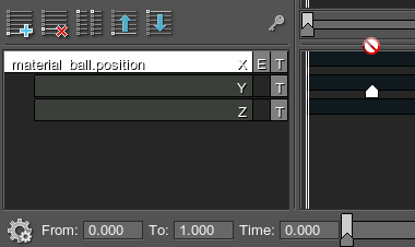

Deleting a Key Frame
删除关键帧#
To delete a key frame, select it on the line and drag the mouse upwards.要删除关键帧,请在线选择它并向上拖动鼠标。
The other ways to delete the key is to click or press Delete.删除密钥的其他方法是单击 或按 Delete

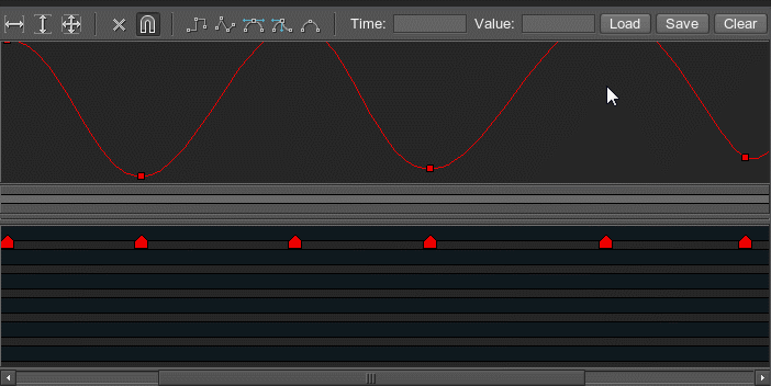

For parameters with values, you can also enable the tracker graph by clicking to the right of the parameter in the tracks list.对于带值的参数,您也可以通过在轨迹列表中单击参数右侧的 来启用轨迹图。
Simple tracks (like tracks that toggle objects on and off) do not have a graph.简单的轨道(如打开和关闭对象的轨道)没有图表。
The graph allows editing key frames as well as the track line. It also displays the transition mode set for the key frame.该图允许编辑关键帧以及轨道线。它还显示过渡模式设置为关键帧。
  • To change the graph arrange mode, use the special icons.要更改图形排列模式,请使用特殊图标.
  • To move around the graph, hold the middle mouse button while dragging it.要在图形中移动,请在拖动时按住鼠标中键。
  • To scale the graph, hold the right mouse button while moving the mouse up or down. At that, the tracks list will also be scaled.缩放图形,请在向上或向下移动鼠标的同时按住鼠标右键。此时,曲目列表也将被缩放。
