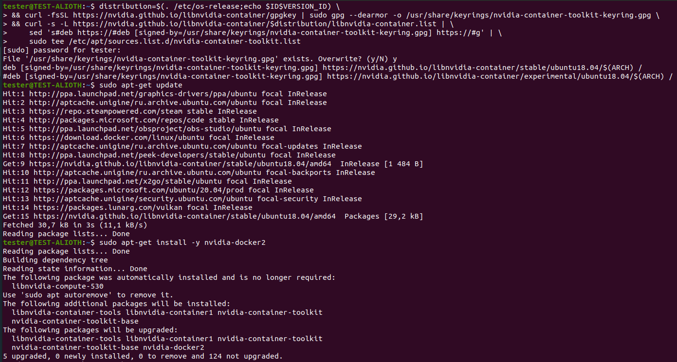

  1. Configure NVIDIA Container Toolkit according to its configuration documentation. Install the package repository and the GPG key, type the command line for that:根据其配置文档,配置NVIDIA Container Toolkit。安装包存储库和GPG键,键入命令行:
    输出
    $ distribution=$(. /etc/os-release;echo $ID$VERSION_ID) \
    && curl -fsSL https://nvidia.github.io/libnvidia-container/gpgkey | sudo gpg --dearmor -o /usr/share/keyrings/nvidia-container-toolkit-keyring.gpg \
    && curl -s -L https://nvidia.github.io/libnvidia-container/$distribution/libnvidia-container.list | \
        sed 's#deb https://#deb [signed-by=/usr/share/keyrings/nvidia-container-toolkit-keyring.gpg] https://#g' | \
        sudo tee /etc/apt/sources.list.d/nvidia-container-toolkit.list
  2. Install nvidia-docker2:安装nvidia-docker2:
    输出
    $ sudo apt-get update
    $ sudo apt-get install -y nvidia-docker2
  3. Restart Docker:重启Docker:
    输出
    $ sudo systemctl daemon-reload
    $ sudo systemctl restart docker

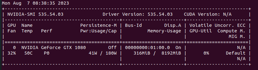

    # nvidia-smi
  3. Check selected GPU drivers with the following command: glxinfo | grep "OpenGL". You will see the full information about your GPU. Or use the command glxinfo | grep "OpenGL renderer" to display the model name of the GPU used. An example of the response:使用以下命令检查选定的GPU驱动程序:glxinfo | grep "OpenGL"。您将看到有关GPU的完整信息。或者使用命令glxinfo | grep "OpenGL renderer"显示所用GPU的型号名称。响应的一个例子:
