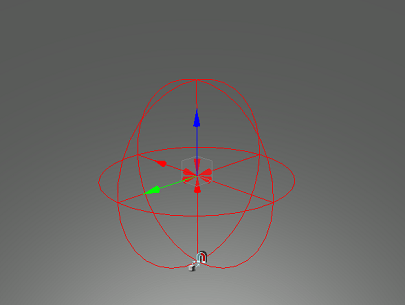

A Physical Force is a spherical object with a force that is applied to its center and attenuates as follows: Physical Force是一个球形物体,其力被施加到其中心,并且衰减如下:
Here:这里:
Name Description
distancedistance Distance between the sphere center and the object.球心与物体之间的距离。
radiusradius Radius of the sphere in which the force is applied.施加力的球体的半径。
attenuationattenuation Force attenuation factor.力衰减系数。
All physical bodies and particles that are within the radius of the force are pulled up to or away from the center of the Physical Force node. Also the bodies and particles can be rotated around the center of the Physical Force node.力半径范围内的所有物理物体和粒子都被拉到Physical Force节点的中心或远离其中心。物体和粒子也可以是旋转的围绕Physical Force节点的中心。

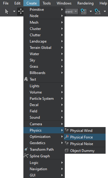

To add a Physical Force to the scene via UnigineEditor:通过UnigineEditor将Physical Force添加到场景中:
  1. Run the project with UnigineEditor.跑步UnigineEditor的项目。
  2. On the Menu bar, click Create -> Physics -> Physical Force.在菜单栏上,单击Create -> Physics -> Physical Force
  3. Click somewhere in the world to place the Physical Force.单击世界上的某个地方以放置Physical Force

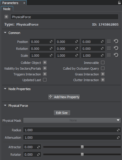

In the Physical Force section (Parameters window -> Node tab), you can adjust the following parameters of the Physical Force:Physical Force部分(Parameters窗口→Node选项卡)中,可以调整Physical Force的以下参数:

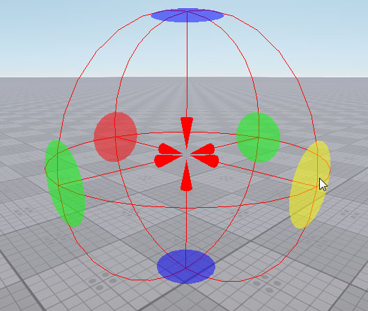

Edit Size
Toggles the editing mode for the Physical Force node. When enabled, the radius of applying the physical force can be changed: each axis is highlighted with the colored circle. To change the radius along the axis, drag the corresponding circle.切换Physical Force节点的编辑模式。启用后,可以更改施加物理力的半径:每个轴以彩色圆圈突出显示。要更改沿轴的半径,请拖动相应的圆。
Physical Mask Physical mask. The physical mask of the Physical Force must match the Physical mask of the physical object. Otherwise, the physical force won't affect the object.Physical掩码。 Physical Force的物理掩码必须比赛物理对象的Physical掩码。否则,物理力将不会影响对象。
Radius Radius for applying the physical force in units.半径,以单位为单位施加物理力。
Attenuation Attenuation factor indicating how much the physical force decreases when the objects move away from the force center.衰减因子,指示当对象从力中心移开时,物理力会减少多少。
Attractor Attraction force applied to objects in the Physical Force radius. If a positive value is provided, objects will be pulled away from the force point. If a negative value is provided, objects will be pulled up to the force point.施加在Physical Force半径范围内的对象的吸引力。如果提供正值,则物体将被拉离受力点。如果提供负值,则物体将被拉至受力点。
Rotator Rotation force that is applied to objects in the Physical Force radius. If a positive value is provided, objects will be rotated clockwise. If a negative value is provided, objects will be rotated counter-clockwise.施加到Physical Force半径内的对象的旋转力。如果提供正值,则对象将顺时针旋转。如果提供负值,则对象将逆时针旋转。
