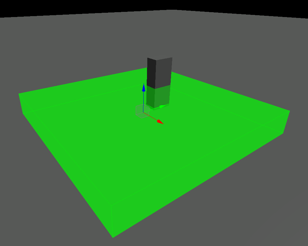

    A cuboid-shaped ObjectMeshDynamic node placed inside the Navigation Sector放置在Navigation Sector内的长方体形状的ObjectMeshDynamic节点

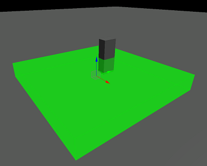

  3. Set the required size for the obstacle.设置障碍物所需的大小。
    The obstacle box and the node.障碍箱和节点。

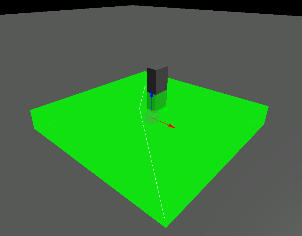

In the result, the route will be calculated as follows (the route is highlighted with white):结果,将按以下方式计算路线(路线以白色突出显示):
The route that bypasses the node marked as the obstacle box绕过标记为障碍箱的节点的路线
