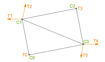

On the picture below, arrows are used to show normals:
Surface that contains 2 adjacent triangles. Here C0...C3 are coordinate vertices, T0...T5 are triangle vertices
The coordinate buffer is an array of coordinate vertices. In order to reduce data duplication, vertices of surface which have the same coordinates are saved only once in the buffer. For example, the coordinate buffer for the surface presented on the picture above is the following:
Output
CB = [C0,C1,C2,C3]
Each polygon of the surface has 3 coordinates. We have 2 polygons, thus, we have 6 vertices, but we save in the CVertices buffer only 4, because 2 of them have the same coordinates. Each coordinate vertex contains coordinates (float[3]) of the vertex.
The number of vertices and coordinate vertices is the same.
The triangle buffer is an array of triangle vertices. For example, the triangle buffer for the surface presented on the picture above is the following:
Output
TB = [T0,T1,T2,T3,T4,T5]

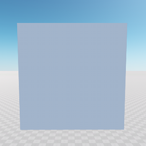

Creating a Surface from Scratch#
The Mesh class allows creating a surface and adding vertices to it.
In the following example, we create a plane by adding vertices to the mesh:
  1. Create a Mesh class instance, add a surface and 4 vertices to it.
  2. Add 6 indices to create a plane.
    You can add indices explicitly as in the example below, or you can create indices for recently added vertices by using the createIndices() function.
  3. Create tangents and normals by using the createTangents() and createNormals() functions.
  4. Update bounds of the mesh to include all new vertices via the createBounds() function.
  5. Create an ObjectMeshDynamic instance using the mesh to check the result.
AppWorldLogic.cpp
#include "AppWorldLogic.h"
#include <UnigineObjects.h>
AppWorldLogic::AppWorldLogic()
AppWorldLogic::~AppWorldLogic()
int AppWorldLogic::init()
	// create a mesh instance
	// add a new surface
	mesh->addSurface("surface_0");
	// add vertices of the plane
	mesh->addVertex(vec3(0.0f, 0.0f, 0.0f), 0);
	mesh->addVertex(vec3(0.0f, 0.0f, 1.0f), 0);
	mesh->addVertex(vec3(0.0f, 1.0f, 0.0f), 0);
	mesh->addVertex(vec3(0.0f, 1.0f, 1.0f), 0);
	// add indices
	mesh->addIndex(0, 0);
	mesh->addIndex(1, 0);
	mesh->addIndex(2, 0);
	mesh->addIndex(3, 0);
	// create tangents
	mesh->createTangents(0);
	// create mesh bounds
	mesh->createBounds(0);
	// create normals
	mesh->createNormals(0);
	// create an ObjectMeshDynamic from the Mesh instance
	ObjectMeshDynamicPtr dynamicMesh = ObjectMeshDynamic::create(mesh);

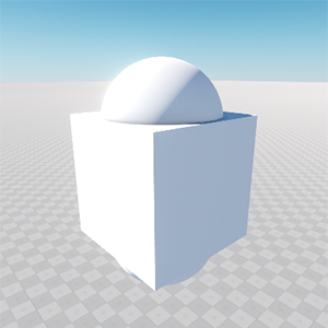

Copying Surfaces from One Mesh to Another#
In the following example, we create two meshes with different surfaces. The first mesh has the capsule surface, the second has the box surface. We copy the box surface from the second mesh to the first. The execution sequence is:
  • Create 2 instances of the Mesh class and add the capsule and box surfaces to them.
  • Add the box surface from the second mesh (mesh_1) to the first mesh (mesh_0) by using the addMeshSurface() function.
  • Create a new ObjectMeshDynamic mesh from the mesh_0 instance.
AppWorldLogic.cpp
	// create mesh instances
	MeshPtr mesh_0 = Mesh::create();
	MeshPtr mesh_1 = Mesh::create();
	// add surfaces for the added meshes
	mesh_0->addCapsuleSurface("capsule_surface", 1.0f, 2.0f, 200, 100);
	mesh_1->addBoxSurface("box_surface", vec3(2.2f));
	// add the surface from the mesh_1 to the mesh_0 as a new surface
	// with the name "new_box_surface"
	mesh_0->addMeshSurface("new_box_surface", mesh_1, 0);
	ObjectMeshDynamicPtr dynamicMesh = ObjectMeshDynamic::create(mesh_0);
	// set the position of the dynamic mesh
	dynamicMesh->setWorldTransform(translate(Vec3(10.0f, 10.0f, 10.0f)));
In the result, the Mesh will have 2 surfaces.
You can copy a surface from the source mesh and add it to the existing surface of the current mesh without creating a new surface by using the overloaded addMeshSurface() function.
The ObjectMeshDynamic mesh will appear in the editor:
ObjectMeshDynamic with 2 surfaces

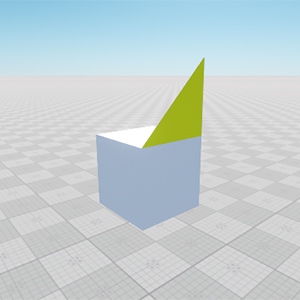

Adding a Surface to the Existing Mesh#
In the following example, we add a surface to the existing mesh and then add necessary vertices and indices for the surface:
  1. Create a new mesh instance from the file.
  2. Add a new surface to the mesh.
  3. Add vertices for the mesh surface.
  4. Create indices for recently created vertices by using the createIndices() function.
  5. Update bounds of the mesh to include the created surface by using the createBounds() function.
  6. Change the surface color.
AppWorldLogic.cpp
	// load a mesh from the file
	MeshPtr source_mesh = Mesh::create("core/meshes/box.mesh");
	source_mesh->addSurface("surface_triangle");
	// add 3 vertices to the new surface
	source_mesh->addVertex(vec3(-0.5f, 0.5f, 0.5f), 1);
	source_mesh->addVertex(vec3(-0.5f, -0.5f, 0.5f), 1);
	source_mesh->addVertex(vec3(-0.5f, -0.5f, 1.5f), 1);
	// create indices for the new surface
	source_mesh->createIndices(1);
	// create a new boundbox for the mesh including new surface
	source_mesh->createBounds();
	// create an ObjectMeshStatic, switch it to procedural mode and set its mesh via the source_mesh instance
	ObjectMeshStaticPtr staticMesh = ObjectMeshStatic::create();
	staticMesh->setMeshProceduralMode(true);
	staticMesh->applyMeshProcedural(source_mesh);
	staticMesh->setMaterialParameterFloat4("albedo_color", vec4(255, 255, 0, 255), 1);
The triangle surface added to the mesh:

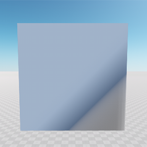

When setTangent() and setNormal() functions were called, the normal and the tangent changed their values.
Let's comment this part of the code:
AppWorldLogic.cpp
// get the tangent value
quat tangent = mesh->getTangent(0, 0, 0);
// show the tangent value in the console
Log::message("tangent: %0.1f %0.1f %0.1f %0.1f\n",tangent.x, tangent.y, tangent.z, tangent.w);
// set a new value of the tangent
mesh->setTangent(0, quat(vec3(1.0f, 0.0f, 0.0f), 20), 0, 0);
// get the new tangent value
quat new_tangent = mesh->getTangent(0, 0, 0);
// show the tangent value after changing
Log::message("tangent: %0.1f %0.1f %0.1f %0.1f\n",new_tangent.x, new_tangent.y, new_tangent.z, new_tangent.w);
The result will be different. You can see what influence the tangent has on the vertex:
Plane with changed tangent
Plane with unchanged tangent
