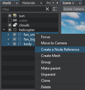

You can also convert a single node or a group of selected nodes in the World Nodes Hierarchy window via the context menu. To do so, select the desired node(s) in the World Nodes Hierarchy window, right-click on the selected node and choose Create a Node Reference. A corresponding *.node asset (source), containing the selected node (or a group of nodes as children with a Dummy Node as the root), will be created in the current folder opened in the Asset Browser. Selected nodes will be replaced with a reference to this asset.您还可以通过上下文菜单在 World Nodes Hierarchy 窗口中转换单个节点或一组选定的节点。为此,请在World Nodes Hierarchy窗口中选择所需的节点,右键单击所选节点,然后选择Create a Node Reference。将在资源浏览器中打开的当前文件夹中创建一个包含选定节点(或一组节点的子节点,其根为Dummy Node)的对应*.node资源(源)。所选节点将被对此资源的引用替换。
