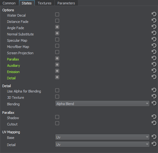

States#
States
Materials editor, States tab.
Options#
Water Decal#

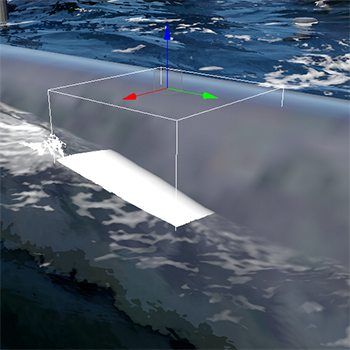

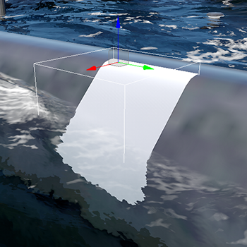

In case of enabling the Water Decal option, decals are projected only on the top of the water surface. When the option is disabled, decals are displayed on the meshes overwater and underwater.
Water Decal option is disabled
Water Decal option is enabled
Distance Fade#
Distance Fade enables smooth fading depending on the distance to the surface where decal is projected. It activates Distance threshold and Distance power
Angle Fade#
When you enable Angle Fade option, the angle of the surface will have influence of the decal projection. Enabling this option activates Angle threshold and Angle power parameters that allow to modify the angle where the decal shouldn't be projected.
The angle threshold allows you to increase the slope for projecting overlap material. It can even be rendered on surfaces that face downwards.
Normal Substitute#
Normal substitute specifies a rendering mode for normals. By default, normal maps of a base and overlapping material are combined together. with this option enabled, only normals of the overlapping material are used
Normal substitute off
Normal substitute on
Specular Map#
The state defines whether to use the B channel of the Shading texture as a specular texture.
Microfiber Map#
The state defines whether to use the A channel of the Shading texture as a microfiber texture.
Screen Projection#
Enables volumetric projection of the decal following the shape of the mesh.
Screen Projection disabled
Screen Projection enabled
Auxiliary#
Enables Auxiliary rendering pass for the material. Can be used for custom post-effects, such as thermal vision etc. Activates the auxiliary texture and parameter.
Emission#
Enables Emission effect for the material. Activates the emission texture and parameters.
Parallax#
Enables Parallax states used for providing a convex relief based on a parallax (height) texture.
Detail#
Enables Detail states used for bringing detalization to the decal material.
Detail States#
Detail activates a set of textures (albedo, normal, shading) to form a material layer. It is applied for bringing detalization to the decal material.
Use Alpha for Blending#
Use alpha for blending option indicates whether to use the alpha channel of the detail texture for blending.
3D Texture#
3D Texture option indicates whether to use 3D texture for the decal.
Blending#
Available options are:
  • Alpha Blend - blending depends on the alpha channel of the base albedo texture.
  • Overlay - depending on the base albedo texture color, the base and detail textures colors are either multiplied (for dark color pixels) or screened (for light color pixels), which leads to the contrast increase while preserving highlights and shadows. Grey pixels are not effected at all. The blending is applied to the first UV coordinates of the mesh.
  • Multiply - the base albedo texture color is multiplied by the detail texture color, resulting in darker colors. White pixels are not effected at all. The blending is applied to the first UV coordinates of the mesh.
Parallax States#
Parallax mapping enables the parallax effect that provides a convex relief based on a parallax (height) texture.
Shadow#
Apply the parallax shadow effect.
Cutout#
Apply the cutout effect that provides smooth edges between the opaque and transparent areas.

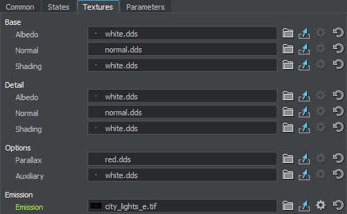

Textures#
Availability of some textures depends on the set States values.
Materials editor, Textures tab.
Base Textures#

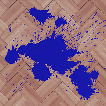

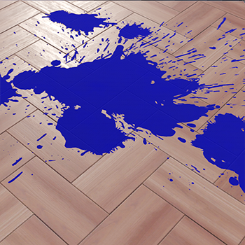

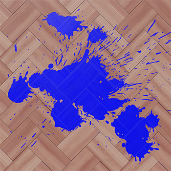

Albedo#
Albedo texture indicates the main color of the decal.
Albedo texture applied
Albedo texture applied (another angle view)

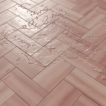

Normal#
Normal texture stores height information required to achieve an effect of Normal Mapping
Normal texture applied
Normal texture applied (another angle view)
Unigine Engine expects a normal map in DirectX format. If your normal map is in OpenGL format, tick Invert G Channel in the import menu. As a general rule, if the lighting seems weird, try inverting the G Channel and see if it gets better.
Shading#
Shading texture is a container for four different textures:
Metalness#
Metalness texture stores information about material's metalness:
  • White pixels indicate that material is metal.
  • Black pixels indicate that material is dielectric.
Roughness#
Roughness texture stores information about material's roughness:
  • White pixels indicate that material is rough.
  • Black pixels indicate that material is smooth.

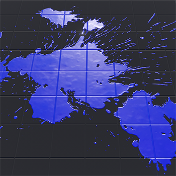

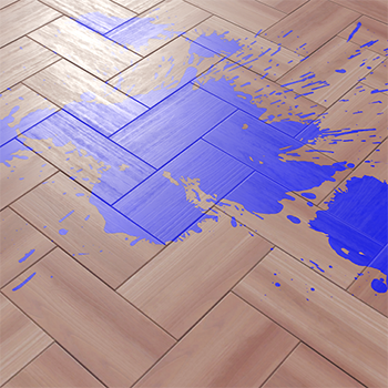

Specular#
Specular texture stores the light reflectance information. It defines shininess and a highlight color of the surface.
To use this channel, enable the Specular Map state.
Specular texture applied
Specular texture applied (another angle view)

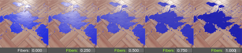

Microfiber#
Microfiber texture creates an effect of napped surface.
To use this channel, enable the Microfiber Map state.
Microfiber texture applied
Microfiber texture applied (another angle view)
Detail Textures#
An additional set of the textures to form a material layer. The set contains all the textures from Base textures group.
Detail textures are available when a Detail option is enabled.
Parallax Texture#
An additional texture to form a parallax effect.
Parallax texture is available when a Parallax option is enabled.
Emission Texture#
An additional texture (3 channels) to store information about a glowing color.
Emission texture is available when a Emission option is enabled.
Auxiliary Texture#
An additional texture (4 channels) to be used for custom post-effects, such as thermal vision, etc.
Auxiliary texture is available when a Auxiliary option is enabled.

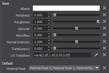

Base Parameters#
Parameters window.

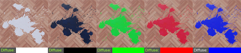

Albedo#
Albedo is a multiplier of the base color of the surface provided by the albedo texture.
Metalness#
Albedo is a multiplier of metalness.
Roughness#
Roughness is a multiplier of the roughness of a surface.
Specular#
Specular is a multiplier for the intensity of highlight provided by the specular texture.
Microfiber#
Microfiber is a coefficient to scale the intensity of the microfiber (provided by a microfiber texture). The higher the value, the higher the microfiber texture effect is.

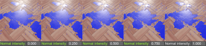

Normal Intensity#
Normal Intensity is an intensity of the relief of the normal texture.

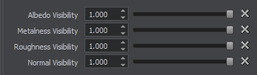

Visibility parameters indicates the influence of different shading effects over the material on which the decal is projected.
Albedo Visibility#
Albedo Visibility - a parameter that specifies the influence of the albedo of the decal over the surface material.
Metalness Visibility#
Metalness Visibility - a parameter that specifies the influence of the metalness texture of the decal over surface material.
Roughness Visibility#
Roughness Visibility - a parameter that specifies the influence of the roughness of the decal over the surface material.
Normal Visibility#
Normal Visibility - a parameter that specifies the influence of the normal texture over the surface material.

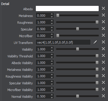

Detail Textures Parameters#
Materials editor, Parameters tab.
A set of the shading parameters for detail material textures:
Albedo#
Albedo - is a multiplier of the detail color of the surface provided by the detail albedo texture similar to the base texture Albedo parameter.
Metalness#
Metalness - a parameter modifying the size of the highlight of the detail texture similar to the base texture Metalness parameter.
Roughness#
Roughness - a parameter modifying the size of the highlight of the detail texture similar to the base texture Roughness parameter.
Specular#
Specular - is a color picker to choose the auxiliary specular color for the detail specular texture similar to the base texture Specular parameter.
Microfiber#
Microfiber - is a color picker to choose the auxiliary microfiber color for the detail microfiber texture similar to the base texture Microfiber parameter.
Albedo Visibility#
Albedo Visible - a parameter that specifies the influence of the detail texture albedo over the base texture albedo.
Metalness Visible - a parameter that specifies the influence of the detail texture metalness over the base texture metalness.
Roughness Visible - a parameter that specifies the influence of the detail texture roughness over the base texture roughness.
Specular Visibility#
Specular Visible - a parameter that specifies the influence of the detail texture specular over the base texture specular.
Microfiber Visibility#
Microfiber Visible - a parameter that specifies the influence of the detail microfiber texture over the base texture.
Normal Visibility#
Normal Visible - a parameter that specifies the influence of the detail normal texture over the base texture.
Detail parameters are present if a Detail option is enabled.

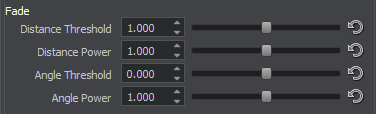

Fade Parameters#
Distance Threshold#
Distance Threshold is a coefficient to scale a threshold fade for projected overlap materials. The higher the value, the bigger area is rendered.
Fade threshold =0
Fade threshold =1
Fade threshold =2
Distance Power#
Distance Power a coefficient that shows the converse intensity of decal depending on the distance. The lower the power value, the bigger area is rendered.
Fade power =0
Fade power =1
Fade power =2

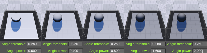

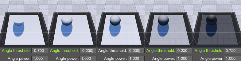

Angle Threshold#
Angle threshold is a threshold angle value. A coefficient to scale a threshold angle for projected overlap materials. The lower the value, the bigger area is rendered.
Angle Power#
Angle Power - Angle fade power, indicates the intensity depending on the angle.

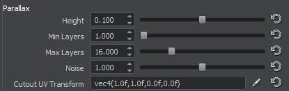

Parallax Parameters#
Parallax parameters
Height#
Height is a coefficient to scale the power of the parallax texture displacements. The higher the value, the bigger the normals are.
Min Layers#
Min layers parameter specifies the minimum step of the parallax mapping.
Max Layers#
Max layers parameter specifies the maximum step of the parallax mapping.
Noise#
Noise parameter specifies the size of the noise used for parallax mapping. The higher the value, the less visible the layers.
Cutout UV Transform#
Cutout UV Transform parameter specifies parallax texture coordinates transformation:
  • (X, Y) - scale
  • (Z, W) - offset.
