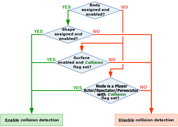

In order for an object to participate in collision detection (i.e. be a collider), it must be added to a specific BSP-tree representing the physics scene. Collision detection is automatically enabled for an object if it has a body assigned or at least one of its surfaces has the Collision flag set. The algorithm of enabling/disabling collision detection is illustrated below.为了使对象参与碰撞检测(即为collider),必须将其添加到表示物理场景的特定BSP树中。如果为对象分配了物体或对象的至少一个表面设置了Collision标志,则自动为对象启用碰撞检测。启用/禁用碰撞检测的算法如下所示。
Algorithm of enabling/disabling collision detection.启用/禁用碰撞检测的算法。
  • Disabling physics simulation globally does not turn off Collision detection.全局禁用物理模拟不会关闭碰撞检测。
  • In case if an object has a body and a shape assigned and enabled, the collision detection algorithms will use only shape's parameters, while the parameters of its surfaces will be ignored.如果对象具有已分配并启用的物体和形状,则碰撞检测算法将仅使用形状的参数,而将忽略其表面的参数。

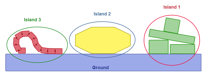

In a constrained physics simulation some objects influence the motion of others, while others don’t. Thus, these objects can be grouped into islands, which are self-contained groups of bodies that can influence the motion of each other in the group through constraint forces/impulses, but do not affect objects belonging to other islands. So, all contacting bodies as well as the ones having joints that connect them are combined in an island.在受限的物理模拟中,某些对象会影响其他对象的运动,而其他对象则不会。因此,可以将这些对象分为,它们是独立的一组物体,可以通过约束力/冲力影响彼此在该组中的运动,但不影响属于其他对象的对象岛屿。因此,所有接触体以及具有连接它们的关节的接触体都合并在一个岛中。
Objects grouped into islands对象分组为孤岛
In case Deterministic mode of physics simulation is enabled bodies, shapes, and joints are sorted inside islands to ensure that contacts are solved in the predefined order and visualization of physics in the world is repetitive (on one computer).如果启用了物理模拟的Stable模式,则在岛内对物体,形状和关节进行分类以确保以预定的顺序解决了接触问题,并且世界上的物理可视化是重复的(在一台计算机)。

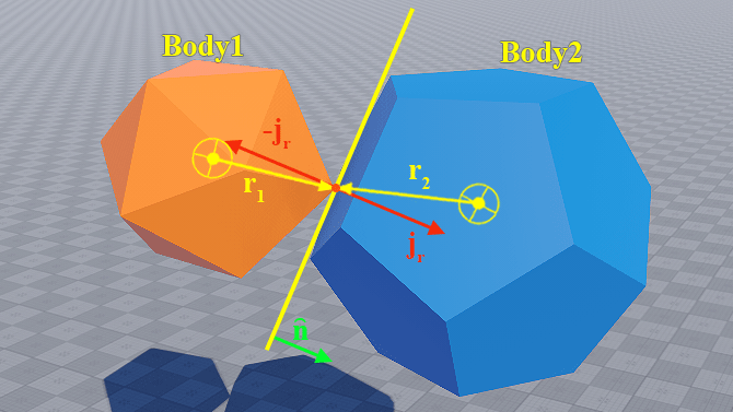

At this stage all found contacts are cached together with contacts from the previous frame — to ensure proper interaction. On the basis of gathered contact points data, UNIGINE computes the impulse a shape gets by collision. Contact points are solved in a pseudo-random order to achieve simulation stability and reproducibility.在此阶段,所有找到的联系人都与前一帧的联系人一起缓存-以确保正确的交互。根据收集的接触点数据,UNIGINE计算形状通过碰撞得到的脉冲。接触点以伪随机顺序求解,以实现仿真稳定性和可重复性。
Joints are solved in the process of contact response calculation. The impulses that joints give the bodies attached to them are computed: how according to the current state of the joint, the bodies should respond to keep the joint unbroken (i.e. based on their masses, linear and angular velocities, change their movement direction and orientation), and how that response affects the joint (a joint can be broken by a too large impulse). Joints are also solved in the pseudo-random order.关节在接触响应计算过程中得到解决。计算关节给予与之相连的物体的冲动:根据关节的当前状态,物体应如何响应以使关节保持不破裂(即,基于其质量,线速度和角速度,更改其运动方向和方向),以及该响应如何影响关节(过大的脉冲可能会破坏关节)。关节也以伪随机顺序求解。
Within one physics iteration, joints can be solved several times. High number of joint iterations increases the precision of calculations, as well as computational load.在一次物理迭代中,关节可以求解多次。联合迭代次数很多,可以提高计算精度以及计算量。
The results of contact and joint solving are accumulated and applied to bodies. The coordinates of the bodies change according to their new linear and angular velocities.累积了接触和联合求解的结果并将其应用于实体。物体的坐标根据其新的线性和角速度而变化。

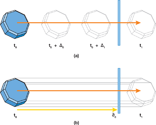

Regarding the way the time scale is considered, two basic approaches to finding contact points in case of collision are used. Both of these approaches are implemented in UNIGINE.关于时间刻度的考虑方式,使用了两种在发生碰撞时查找接触点的基本方法。这两种方法都是在UNIGINE中实现的。
  • Discrete collision detection is performed in certain intervals of time and each frame is treated separately from others. In general, discretization improves performance. However, when a project framerate is already low, a small fast-moving object is likely to teleport from one point to another instead of moving there smoothly and collision will not be detected.离散冲突检测是在一定时间间隔内执行的,每个帧都与其他帧分开处理。通常,离散化可以提高性能。但是,当项目帧速已经很低时,一个小的快速移动物体很可能会从一个点传送到另一个点,而不是平稳地移动到那一点,并且不会检测到碰撞。
  • Continuous collision detection does not suffer this problem as the moving body is extruded along its trajectory (between two adjacent frames). In cases when something gets into this volume and a collision is detected, the body is taken back in time to correct the collision reaction.
    Continuous collision detection is available for sphere and capsule shapes only.Continuous collision detection is available for sphere and capsule shapes only.
    连续碰撞检测不会遇到此问题,因为移动体沿其轨迹(在两个相邻帧之间)被挤压。如果有物体进入该体积并检测到碰撞,则及时收回车身以纠正碰撞反应。
    Continuous collision detection is available for sphere and capsule shapes only.连续碰撞检测仅可用于球形胶囊形状。
Discrete (a) and continuous (b) collision detection离散(a)和连续(b)冲突检测
The primary advantage of discrete detection is that it tends to be much faster and simpler for objects with complex shape or large size. Continuous collision detection requires mathematical descriptions of all objects and their motions and the solving systems of equations, which can be difficult, slow, or even impossible in many circumstances.离散检测的主要优点是,对于形状复杂或尺寸较大的对象,它往往会更快,更简单。连续碰撞检测需要对所有对象及其运动以及方程的求解系统进行数学描述,这在许多情况下可能是困难,缓慢甚至是不可能的。

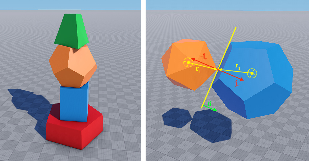

Basically there are two types of contacts:基本上有两种类型的联系人:
  • Static, when the body rests on another body. In this case, bodies are considered "frozen" until an external force affects them. This makes it possible to avoid unnecessary calculations.静态,当尸体放在另一个尸体上时。在这种情况下,除非有外力影响物体,否则将其视为“ frozen”。这样可以避免不必要的计算。
  • Dynamic, when two bodies, at least one of which is moving, collide. In this case, we have to calculate instantaneous change of velocities for both colliding objects.动态,当至少有一个正在移动的两个物体碰撞时。在这种情况下,我们必须计算两个碰撞对象的瞬时速度变化。
Static (left) and dynamic (right) contacts静态(左)和动态(右)联系人
