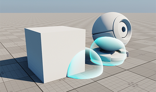

Both these components are added together and saturated.这两个组件都是添加一起和饱和的.
The result结果
