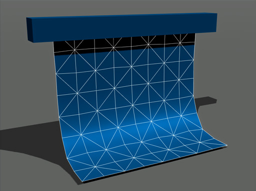

In most cases, it is important that polygon triangulation of the mesh, for which Cloth body is generated, is as illustrated! Otherwise, it may not stretch properly and evenly in all directions.在大多数情况下,生成 Cloth body 的网格的多边形三角剖分非常重要,如图所示!否则可能不会拉紧正确且均匀地向各个方向。
Required mesh triangulation
For example in 3ds Max, mesh topology needs to be edited manually: choose Modify > Selection > Edit Edges rollout and click Turn to turn the triangles in a poly.例如在 3ds Max 中,需要手动编辑网格拓扑:选择 Modify > Selection > Edit Edges 卷展栏并单击 Turn 将三角形转为多边形。

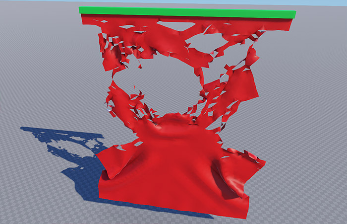

Tearing
撕裂#
When the cloth is stretched beyond its elastic limit or folded, it tears and shreds into pieces. Tearing is caused by applying the force or collision with a physical body, and depends on the cloth stiffness (controlled by linear and angular restitution parameters). For example, imagine the cannonball hitting the sail and leaving the hole in it. The cloth is torn only along the edges of cloth triangles, splitting mesh vertices and duplicating particles.当布料被拉伸超过其弹性极限或折叠时,它会撕裂并撕成碎片。撕裂是由施加力或与物理物体碰撞引起的,并且取决于布料的刚度(由控制线性角度恢复参数)。例如,想象炮弹击中帆并在帆上留下洞。布料仅沿布料三角形的边缘撕裂,分裂网格顶点并复制粒子。
Cloth tearing
Tearing of cloth布料撕裂
If torn pieces of cloth fall onto one plane, they cause Z-fighting.如果撕裂的布块落在一个平面上,它们会引起 Z-fighting。

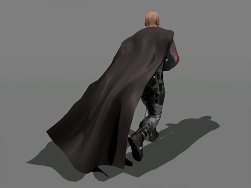

Attaching the Cloth
连接布料#
I'm Batman!
Cloth attached to animated character附加到动画角色的布料
A cloth can be attached to the following types of bodies:布可以附着在以下类型的物体上:
To attach a cloth to a body use a Particles Joint. In case of Rigid bodies (either static, or dynamic) and Dummy bodies, pinned particles stay fixed in their position and follow transformations of attached objects pulling the cloth with it.要将布料附加到物体,请使用 Particles Joint。在 Rigid 实体(静态或动态)和 Dummy 实体的情况下,固定粒子保持固定在其位置并跟随附着对象的变换拉动布料。

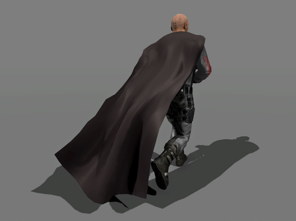

Attachment to Skinned Mesh
附加到Skinned Mesh#
Convincing simulation of the clothing on a skinned character requires a different approach. To follow bones transformations, each vertex of the cloth that is found in the Particles Joint area is mapped to the nearest skinned mesh vertex (up to the distance specified by the Threshold parameter of the particles joint).令人信服的模拟皮肤角色的服装需要不同的方法。为了遵循骨骼变换,在 Particles Joint 区域中找到的布料的每个顶点都映射到最近的蒙皮网格顶点(最多由粒子关节的 Threshold 参数指定的距离)。
It is not recommended to attach the cloth directly to the skinned character, because difference in topologies may result in visual artifacts. Instead of it, it is better to create an identical cloth surface on the skinned mesh character, make it invisible and attach a physical cloth to it.不建议将布料直接贴在蒙皮角色上,因为拓扑不同可能会导致视觉伪影。取而代之的是,最好在蒙皮网格角色上创建相同的布料表面,使其不可见并在其上附加物理布料。
For example, we need to create a cape that is glued to the shoulders of a skinned character while the rest flaps and folds loosely. It is done in the following steps:例如,我们需要创建一个披风,它粘在蒙皮角色的肩膀上,而其余部分则松散地襟翼和折叠。它是通过以下步骤完成的:
  1. When creating a Mesh Skinned, add a cape surface identical to the cape that the character would wear. It can be either a whole cape, or only its clipped part that needs to be pinned. The latter is preferable when complex clothing is simulated, which requires more flexible control over which parts to simulate physically and which ones to move with skinned character. In our case, it's cloth part over the shoulders.创建 Mesh Skinned 时,添加与角色将穿的披风相同的披风表面。它可以是整个披风,也可以只是需要固定的剪裁部分。当模拟复杂的服装时,后者更可取,这需要更灵活地控制哪些部分进行物理模拟,哪些部分与蒙皮角色一起移动。在我们的例子中,它是肩膀上的布料部分。
  2. Add skinned mesh that has a Ragdoll body assigned. Make sure that the cape surface is enabled.添加分配了 Ragdoll body 的蒙皮网格。确保启用了斗篷表面。
  3. Add a separate dynamic cloth mesh and synchronize its position with skinned character. Turn off physical simulation (CTRL + SPACE) and assign a Cloth body.添加单独的动态布料网格并将其位置与蒙皮角色同步。关闭物理模拟 (CTRL + SPACE) 和分配Cloth body
  4. Attach Cloth body to Ragdoll body. If the Threshold distance of the particles joint is set low enough, the physical cape will be automatically attached only to the cape surface (i.e. shoulders). After that, the cape surface is simply disabled and does not provide any load at all.Cloth bodyRagdoll body。如果particles关节的 Threshold 距离设置得足够低,物理披风将自动仅附加到披风表面(即肩部)。之后,斗篷表面被简单地禁用并且根本不提供任何负载。
