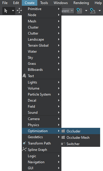

To create Occluder via UnigineEditor:要通过UnigineEditor创建Occluder,请执行以下操作:
  1. Run the project with UnigineEditor.跑步UnigineEditor的项目。
  2. On the Menu bar, click Create -> Optimization -> Occluder.在菜单栏上,单击Create -> Optimization -> Occluder
  3. Place the Occluder in the world and specify the required parameters for it.Occluder放置在世界上,为其指定所需的参数

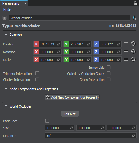

On the Node tab of the Parameters window, you can adjust the following parameters of Occluder:Parameters窗口的Node选项卡上,可以调整Occluder的以下参数:

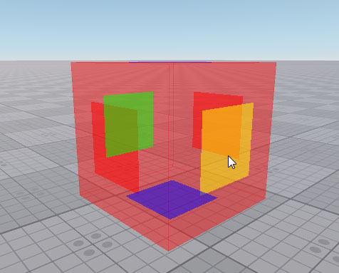

Edit Size
Toggles the editing mode for the Occluder node on and off. When enabled, the Occluder box sides that can be resized are highlighted with the colored rectangles. To change the size of a side, drag the corresponding rectangle.开启和关闭Occluder节点的编辑模式。启用后,可以调整大小的Occluder框边会用彩色矩形突出显示。要更改边的大小,请拖动相应的矩形。

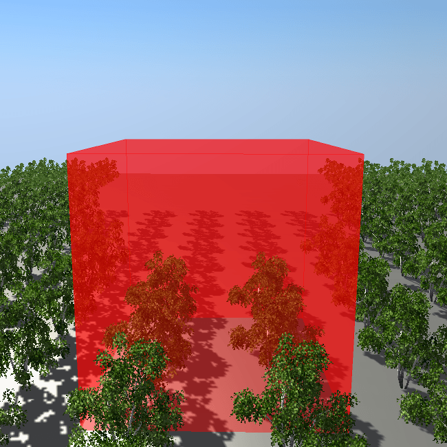

Back Face
Indicates whether the back faces of the Occluder box are used instead of front faces to occlude objects. If unchecked, the front faces will be used.指示是否使用Occluder框的背面而不是正面来遮挡对象。如果未选中,将使用正面。
Back Face is uncheckedBack Face未选中
Back Face is checkedBack Face已检查
Size Size of Occluder along the axes.沿轴的大小为Occluder
Distance
Distance between the camera and the bounding box of Occluder, at which the Occluder becomes disabled (it isn't processed by the CPU, hence it isn't rendered).相机与Occluder边界框之间的距离,在该距离处将禁用Occluder(CPU不会处理它,因此不会渲染它)。
For example, you should disable Occluder at a certain distance if it stops hiding the objects and their surfaces, in order to increase performance.例如,如果Occluder停止隐藏对象及其表面,则应在一定距离处禁用它,以提高性能。
By default, the parameter value is set to inf.默认情况下,参数值设置为inf
