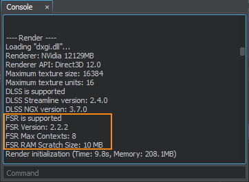

The upscalers are initialized on render initialization. To verify whether they are supported and initialized after application startup, you can do one of the following:升频器在渲染初始化时初始化。 要验证它们是否受支持并在应用程序启动后初始化,可以执行以下操作之一:
  • Check the Render section of the console output.检查控制台输出的Render部分。
  • Run the dlss_info and/or fsr_info console commands.运行dlss_info和/或fsr_info控制台命令。
For example, the Render section may provide the following information:例如,Render部分可以提供以下信息:
源代码
---- Render ----
DLSS is supported
DLSS Streamline version: 2.4.0
DLSS NGX version: 3.7.0
FSR is supported
FSR Version: 2.2.2
FSR Max Contexts: 8
FSR RAM Scratch Size: 10 MB

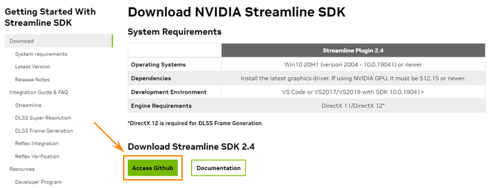

  1. Follow this link to download the NVIDIA Streamline SDK, which serves as a wrapper for DLSS and all its features.按照此链接下载NVIDIA Streamline SDK,它用作包装器 适用于 DLSS 及其所有功能。
  2. Click Access Github.点击Access Github

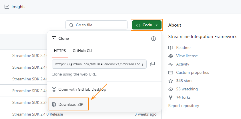

  3. 在打开的页面上,单击绿色的Code按钮,然后从下拉列表中选择Download ZIP
  4. 导航到包含下载的Streamline-main.zip存档的文件夹。 这通常是Downloads文件夹。
  5. Extract the ZIP archive. By default, it is extracted to the streamline-sdk-v2.7.32 folder. However, you can rename it if necessary.解压缩ZIP存档。 默认情况下,它被提取到Streamline-main文件夹。 但是,如果需要,您可以重命名它。

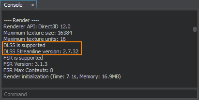

  9. In UnigineEditor, open the console and check that DLSS is available. The corresponding information is provided in the Render section:在UnigineEditor中,打开控制台并检查DLSS是否可用。 相应的信息在Render部分提供:
    If DLSS is not available, the corresponding message will be shown in the console.如果DLSS是不可用,相应的消息将显示在控制台中。

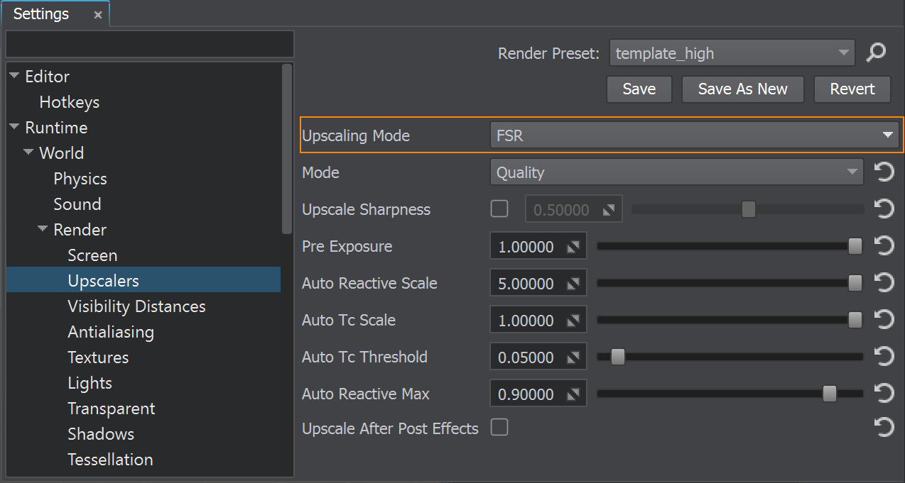

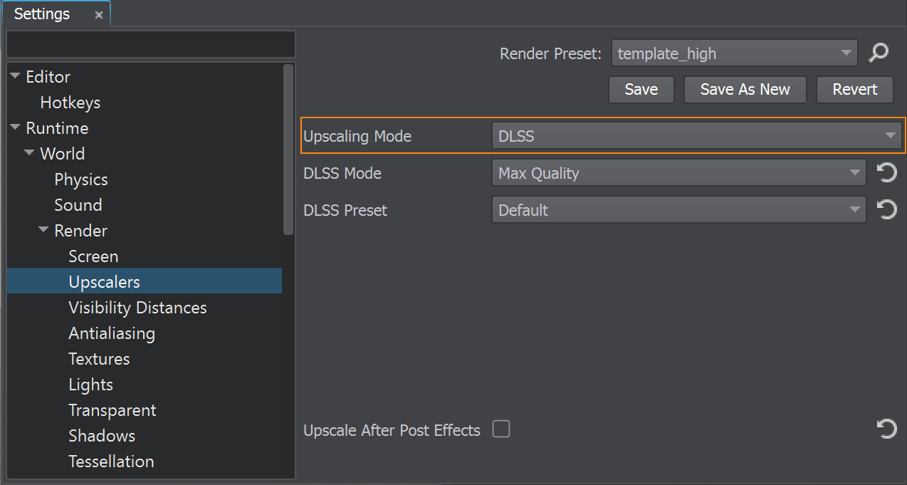

To use DLSS for the scene, enable it in one of the following ways and specify settings:要在场景中使用DLSS,请通过以下方式之一启用它并指定设置:

To use FSR 3 for the scene, enable it in one of the following ways and specify settings:要在场景中使用FSR2,请通过以下方式之一启用它并指定设置:
Settings of Upscalers
升频器的设置#
Depending on the current upscale mode, the set of settings differs. Please refer to the Upscalers article.根据当前的高档模式,设置集不同。 请参阅Upscalers文章。

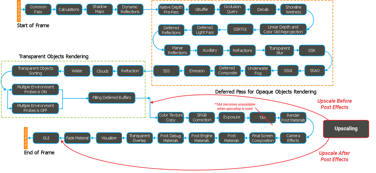

By default, upscaling is applied before all post-processing effects are rendered. However, you can choose to apply upscaling after rendering the post-process effects.默认情况下,在渲染所有后处理效果之前应用放大。 但是,您可以选择渲染后处理效果之后应用放大。
It can be done via the console using the render_upscale_post command or in UnigineEditor by toggling the Upscale After Post Effects parameter.它可以通过控制台使用render_upscale_post命令或在UnigineEditor中通过切换Upscale After Post Effects参数来完成。
