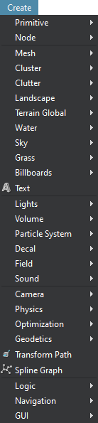

Creating Nodes of Built-In Types
创建内置类型的节点#
UNIGINE provides a set of diverse built-in node types that can be used to represent virtually any object or phenomenon present in real life. These node types are formed into several groups. UNIGINE提供了一组内置节点类型,这些节点类型可用于表示现实生活中的几乎所有对象。这些节点类型分为几组。
You can create a node of any built-in type by selecting the corresponding item in the Create menu and specifying necessary parameters.您可以通过在Create菜单中选择相应的项目并指定必要的参数来创建任何内置类型的节点。
Before creating nodes you have to create a world or open an existing one, otherwise the Create menu will be disabled.在创建节点之前,您必须先创建一个世界或打开一个现有的世界,否则将禁用Create菜单。
创建过程和每个用户可用的参数列表内置节点类型在Built-In Node Types section.

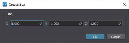

When creating a standard primitive, specify its geometry parameters in the window that opens, as for the Box: 创建标准图元时,将显示带有参数的窗口,如下图所示 Box
Creation parameters for the box primitive框图元的创建参数
Having specified the primitive's parameters and clicking OK you confirm its creation. You can also click Cancel to abort. 指定了原语的参数,然后单击OK确认其创建。您也可以点击取消中止。

Box
The Box primitive provides a simple geometry for representing boxes and cubes. It has the following parameters:图元提供了用于表示框和立方体的简单几何形状。它具有以下参数:
X, Y, Z dimensions along the X, Y, and Z axes.沿X,Y和Z轴的尺寸。
Creation of a primitive produces a corresponding .mesh asset generated based on the specified parameters in the current directory of the Asset Browser window. The primitive shall be created as a Static Mesh.应将具有指定大小的框创建为Static Mesh

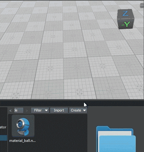

A node can be created by simply dragging an asset from the Asset Browser either to the Editor Viewport or to the World Nodes window. Asset type determines the type of the node (or hierarchy of nodes) that will be created.只需将资源从 资源浏览器 拖动到 Editor视口World Nodes窗口即可创建节点。资源类型确定将要创建的节点的类型(或节点的层次结构)。
Drag-and-drop creation of nodes is supported for the following types of assets:以下类型的资源支持拖放创建节点:

If you drag an asset to the World Nodes window, the created node will be placed right in front of the current camera. While dragging the asset to the Editor Viewport switches the Editor to the Snap to Surface Mode, so you can choose where to place the created node.如果将资源拖动到World Nodes窗口,则创建的节点将放置在当前摄像机的正前方。将资源拖动到 Editor视口时,会将编辑器切换到 捕捉到曲面模式 ,因此您可以选择
Snap to Surface Mode捕捉到表面模式
