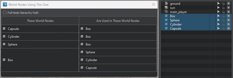

In UnigineEditor you can find all runtime-nodes, that use the selected node or group of nodes, to help avoid accidental removal of nodes somehow used by others, as well as to analyze / validate the logic of node interactions (e.g., to check if the right nodes are used in componets etc.). Just select the desired node or group of nodes, right-click on any of them in the World Nodes Hierarchy window and choose Show World Nodes Using This One.在 UnigineEditor 中,您可以找到使用所选节点或节点组的所有运行时节点,以帮助避免意外删除其他人以某种方式使用的节点,以及分析/验证节点交互的逻辑(例如,检查组件中是否使用了正确的节点等)。只需选择所需的节点或节点组,在World Nodes Hierarchy窗口中右键单击其中任何一个节点,然后选择Show World Nodes Using This One
You'll see a table of dependencies between nodes, it has two columns: the left one contains the list of selected nodes, while the right one shows the nodes that use each of the nodes from the left.您将看到一个节点之间的依赖关系表,它有两列:左边一列包含所选节点的列表,而右边一列显示使用左侧每个节点的节点。
Dependencies between runtime-nodes are valid at the moment they are found. If some nodes have been removed or renamed after displaying the dependencies table, you should use the tool again to take all these changes into account.运行时节点之间的依赖关系在找到它们的那一刻是有效的。 如果在显示依赖关系表后删除或重命名了某些节点,则应再次使用该工具将所有这些更改考虑在内。

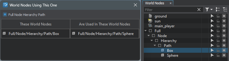

To display the path to the node in the World Nodes Hierarchy check the Full Node Hierarchy Path box.要在World Nodes Hierarchy中显示节点的路径,请选中Full Node Hierarchy Path框。

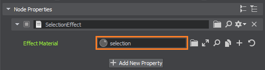

  • Property - a node can be used in the component logic assigned to other nodes (it is assigned to Property / C# Component in the corresponding field).属性-一个节点可以在分配给其他节点的组件逻辑中使用(它被分配给相应字段中的属性/C#组件)。

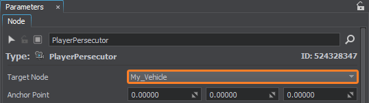

  • PlayerPersecutor - a node can be assigned to the Target Node field in the list of PlayerPersecutor camera parameters to allow the camera to follow the target node.PlayerPersecutor-a节点可以被分配给PlayerPersecutor相机参数列表中的Target Node字段,以允许相机跟随目标节点。

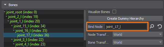

  • Skinned Mesh - a node can be assigned to the Bind Node field of a Skinned Mesh object to control the transformations of the skeletal bone to which it is attached.Skinned Mesh-可以将节点分配给Skinned Mesh对象的Bind Node字段,以控制其附加到的骨骼的转换。

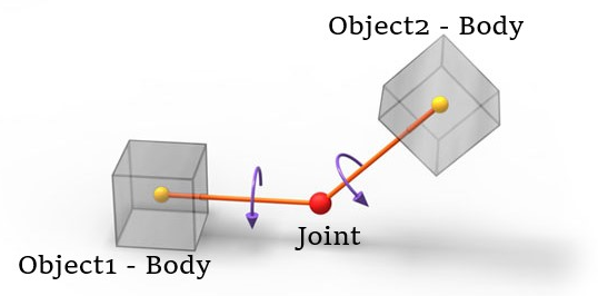

  • Objects having a physical Body can be connected via Joints.具有物理身体对象可以通过关节连接。
