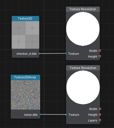

Texture Resolution Node
This node takes an input Texture and outputs its Width and Height, is case a 3D Texure or a 2D Texture Array is connected to the input the node shall also output Depth or the number of Layers.
Example 1
If you want to make a 1-texel UV offset you should know the size of this texel relative to UV, which can be obtained by dividing UV by texture resolution provided by this node.
