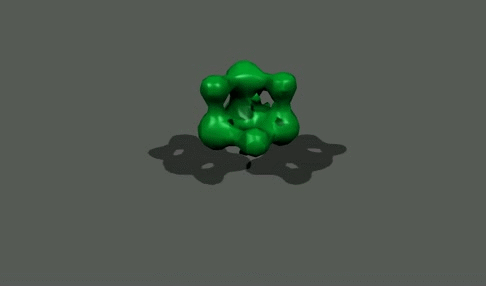

The dynamic_01 sample demonstrates how to create a dynamic mesh by using the Marching cubes algorithm.
In this sample, 3D scalar fields are created one after another.
A dynamic mesh created by means of the Marching cubes algorithm
Also the sample shows, how to start counters for the fields and cubes in the performance profiler. This counters tell the user how many milliseconds have been spent for fields and cubes creation.
