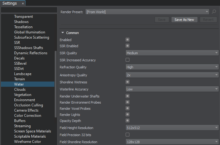

Enabled The value indicating if rendering of water is enabled. by default.
Console access: render_water_enabled (API control)
SSR Enabled The value indicating if the SSR (Screen Space Reflections) effect is enabled for water. by default.
Console access: render_water_ssr (API control)
SSR Quality The resolution of water SSR (Screen Space Reflections). One of the following values:
  • Low - low quality
  • High - high quality
  • Ultra - ultra quality
Console access: render_water_ssr_quality (API control)
SSR Increased Accuracy The value indicating if increased accuracy for the water SSR (Screen Space Reflections). This option reduces visual artifacts by increasing accuracy of the last step. by default.
Console access: render_water_ssr_increased_accuracy (API control)
Refraction Quality The quality of water refraction. One of the following values:
  • Low - low quality
  • Medium - medium quality
  • High - high quality (by default)
Console access: render_water_refraction_quality (API control)
Anisotropy Quality The water texture anisotropy level. The following values are available:
  • 1x - anisotropy level 1
  • 2x - anisotropy level 2
  • 4x - anisotropy level 4
  • 8x - anisotropy level 8
  • 16x - anisotropy level 16
Console access: render_water_anisotropy (API control)
Shoreline Wetness The value indicating if the wetness effect for objects near the shoreline is enabled. by default.
Console access: render_water_shoreline_wetness (API control)
Waterline Accuracy The quality of underwater and waterline determination. Use high quality only if you need to submerge underwater (to see the waterline) and at medium and high Beaufort values. One of the following values:
  • Low - low quality (by default)
Console access: render_water_waterline_accuracy (API control)
Render Underwater Shafts The value indicating if rendering of underwater shafts is enabled. by default.
Console access: render_water_shafts (API control)
Render Environment Probes The value indicating if rendering of environment probes on the water surface is enabled. by default.
Console access: render_water_environment_probes (API control)
Render Voxel Probes The value indicating if voxel probes are enabled for water rendering. by default.
Console access: render_water_voxel_probes (API control)
Render Lights The value indicating if rendering of lights on the water surface is enabled.
by default.
Console access: render_water_lights (API control)
Opacity Depth The value indicating if depth data for water is written to the opacity buffer. by default.
Console access: render_water_opacity_depth (API control)
Field Height Resolution The resolution of the texture into which all textures set for all FieldHeight objects are rendered.
  • 128 x 128
  • 256 x 256
  • 512 x 512 (by default)
  • 1024 x 1024
  • 2048 x 2048
  • 4096 x 4096
  • 8192 x 8192
Console access: render_field_height_resolution (API control)
Field Precision 32 bits The value indicating the precision of textures used for field objects. Either of the following:
  • 16-bit precision R16 texture
  • 32-bit precision R32F texture
Console access: render_field_precision (API control)
Field Shoreline Resolution The resolution of the texture into which all textures set for all FieldShoreline objects are rendered.
  • 128x128 (by default)
  • 256x256
  • 512x512
  • 1024x1024
  • 2048x2048
  • 4096x4096
  • 8192x8192
Console access: render_field_shoreline_resolution (API control)
