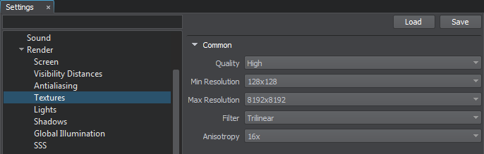

Adjust the global Textures Settings to quickly choose the desired Quality or Maximum Resolution of all textures in the project and thus decrease the video memory consumption. Mipmaps of lower resolution are used for rendering textures of lower quality.调整全局纹理设置快速选择项目中所有纹理的所需质量最大分辨率,从而减少视频内存消耗。较低分辨率的 Mipmap 用于渲染较低质量的纹理。

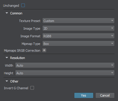

You can control each texture asset in its Import Parameters.您可以控制其中的每个纹理资源导入参数.
It is usually inappropriate to use textures with the Unchanged option enabled unless they have the *.dds or *.texture format. Otherwise, compression may affect the color data a lot (like with custom hdri textures).通常不适合使用启用了 Unchanged 选项的纹理,除非它们具有 *.dds*.texture 格式。否则,压缩可能会对颜色数据产生很大影响(例如使用自定义 hdri 纹理)。
It is crucial to use the correct Texture Preset for every texture, depending on its applicability. Thus, you ensure to use only needed channels and apply a proper compression algorithm. If the list does not provide a required preset, you can select the Custom option and choose the needed options.使用正确的方法很重要纹理预设对于每种纹理,取决于其适用性。因此,您确保只使用需要的通道并应用适当的压缩算法。如果列表未提供所需的预设,您可以选择 Custom 选项并选择所需的选项。
You can also manually select the desired resolution of the texture in the Import Options.您也可以手动选择所需的纹理分辨率导入选项.
