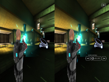

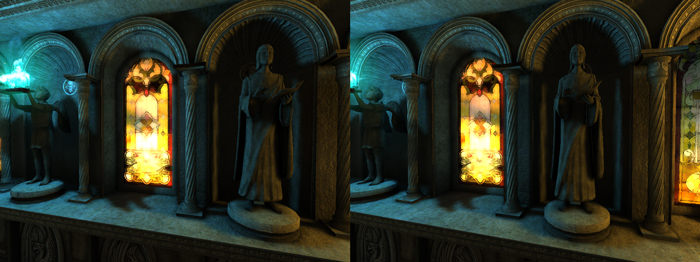

Separate Images
分开的图像#
This mode serves to output two separate images for each of the eye. It can be used with any VR/AR output devices that support separate images output, e.g. for 3D video glasses or helmets (HMD). See further details on rendering below.此模式用于为每只眼睛输出两个单独的图像。它可以与任何支持单独图像输出的VR / AR输出设备一起使用,例如用于3D视频眼镜或头盔(HMD)。请参见下面有关渲染的更多详细信息
To launch Separate images stereo mode, load the Separate plugin.要启动单独的图像立体声模式,请加载Separate插件
Separate images stereo mode单独的图像立体声模式

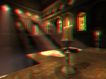

Anaglyph Mode
Anaglyph Mode#
Anaglyph stereo is viewed with red-cyan anaglyph glasses. See further details on rendering below.立体浮雕立体可以通过红-青立体浮雕眼镜观看。请参见下面有关渲染的更多详细信息
To launch Anaglyph stereo mode:要启动Anaglyph立体声模式:
  1. Specify the STEREO_ANAGLYPH definition on the start-up (together with other required CLI arguments).在启动时指定 STEREO_ANAGLYPH 定义(以及其他必需的 CLI 参数)。
  2. Run the 64-bit application (or its debugging version).运行64位应用程序(或其调试版本)。
命令行
main_x64 -extern_define STEREO_ANAGLYPH
Anaglyph stereo mode立体立体立体声模式

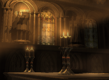

Interlaced Lines
Interlaced Lines#
Interlaced stereo mode is used with interlaced stereo monitors and polarized 3D glasses. See further details on rendering below.隔行立体声模式与隔行立体声监视器和偏光3D眼镜一起使用。请参见下面有关渲染的更多详细信息
In this mode, the vertical resolution of the image is dropped in half.在此模式下,图像的垂直分辨率降低一半。
To launch the interlaced lines stereo mode:要启动隔行扫描立体声模式:
  1. Specify the STEREO_INTERLACED definition on the start-up (together with other required CLI arguments).在启动时指定 STEREO_INTERLACED 定义(以及其他必需的 CLI 参数)。
命令行
main_x64 -extern_define STEREO_INTERLACED
Interlaced lines stereo mode
Interlaced lines stereo mode隔行扫描线立体声模式

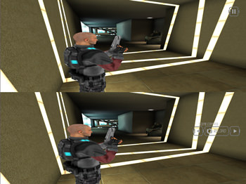

Split Stereo
Split Stereo#
Horizontal and Vertical stereo modes are supported for glass-free MasterImage 3D displays. The same mode (a horizontal or a vertical one) is selected in the graphics chip driver settings. See further details on rendering below.无玻璃的MasterImage 3D显示器支持水平和垂直立体声模式。 在图形芯片驱动程序设置中选择了相同的模式(水平或垂直模式)。 请参见下面有关渲染的更多详细信息
To launch Horizontal stereo mode:要启动水平立体声模式:
  1. Specify the STEREO_HORIZONTAL definition on the start-up (together with other required CLI arguments).在启动时指定 STEREO_HORIZONTAL 定义(以及其他必需的 CLI 参数)。
命令行
main_x64 -extern_define STEREO_HORIZONTAL
Horizontal stereo mode水平立体声模式
To launch Vertical stereo mode:要启动垂直立体声模式:
  1. Specify the STEREO_VERTICAL definition on the start-up (together with other required CLI arguments).在启动时指定 STEREO_VERTICAL 定义(以及其他必需的 CLI 参数)。
命令行
main_x64 -extern_define STEREO_VERTICAL
Vertical stereo mode垂直立体声模式
