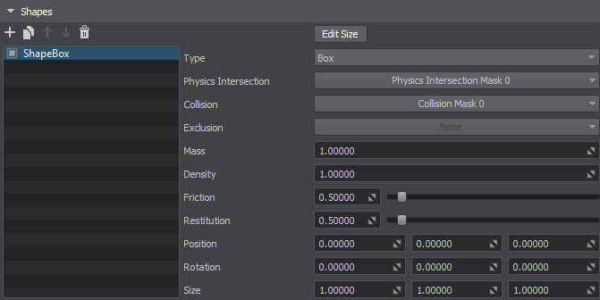

Shapes are configured by a set of parameters, some of which are shape-dependent:形状由一组参数配置,其中一些参数取决于具体的形状类型:
Shape parameters
Edit Size
Toggles the editing mode for the shape in the scene. When the button is pressed, the widget manipulator is available. Each dimension is color-coded in accordance with the axis color. To change the shape along the required axis, drag the corresponding color spot. After editing the shape, click the button once again to exit the editing mode.切换场景中形状的编辑模式。当按钮按下时,控件操作器将可用。每个维度根据轴的颜色进行编码。要沿所需轴更改形状,请拖动相应颜色的点。编辑完形状后,再次点击按钮以退出编辑模式。
Type Type of the shape. It can be changed after creation, while the name will remain unchanged.形状的类型。创建后可以更改,而名称将保持不变。
Continuous A flag indicating if the continuous collision detection is enabled for the shape.
Continuous collision detection is available for sphere and capsule shapes only.Continuous collision detection is available for sphere and capsule shapes only.
一个标志,指示是否对形状启用了连续碰撞检测。
Continuous collision detection is available for sphere and capsule shapes only.连续碰撞检测仅适用于球形和胶囊形。
Physics Intersection mask Physics Intersection bit mask of the shape. Physics Intersection形状的位掩码。
Collision mask Collision bit mask of the shape. This mask is used to specify collisions of the shape with other ones.形状的碰撞位掩码。此蒙版用于指定形状与其他形状的碰撞。
Exclusion mask Exclusion bit mask of the shape. This mask is used to prevent collisions of the shape with other ones.形状的排除位掩码。此蒙版用于防止形状与其他形状发生碰撞。
Mass Mass of the shape. Changing the mass influences the density, which is calculated by dividing the mass by shape volume. In case if there are several shapes assigned to a body (e.g. a set of convex hulls)形状的质量。改变质量会影响密度,密度是通过将质量除以形状体积而得出的。如果有几种形状分配给物体(例如一组凸包)
Density Density of the shape. Changing the density influences the mass, which is calculated by multiplying shape volume by density.形状的密度。更改密度会影响质量,质量是通过将形状体积乘以密度来计算的。
Friction Coefficient of friction of the shape. Defines how rough the shape's surface is. The higher the value, the less tendency the shape has to slide.
In case if an object contains a surface and a shape, both with specified friction parameter, only the shape's parameter will be used.In case if an object contains a surface and a shape, both with specified friction parameter, only the shape's parameter will be used.
形状的摩擦系数。定义形状表面的粗糙度。值越高,形状滑动的趋势越少。
In case if an object contains a surface and a shape, both with specified friction parameter, only the shape's parameter will be used.如果对象包含 surface 和形状(均具有指定的摩擦参数),则仅使用形状的参数。
Restitution Coefficient of restitution of the shape. Defines how bouncy the shape is when colliding.
  • The minimum value of 0 indicates inelastic collisions (a piece of soft clay hitting the floor)The minimum value of 0 indicates inelastic collisions (a piece of soft clay hitting the floor)
  • The maximum value of 1 represents highly elastic collisions (a rubber ball bouncing off a wall)The maximum value of 1 represents highly elastic collisions (a rubber ball bouncing off a wall)
In case if an object contains a surface and a shape, both with specified restitution parameter, only the shape's parameter will be used.In case if an object contains a surface and a shape, both with specified restitution parameter, only the shape's parameter will be used.
The minimum value of 0 indicates inelastic collisions (a piece of soft clay hitting the floor)The maximum value of 1 represents highly elastic collisions (a rubber ball bouncing off a wall)In case if an object contains a surface and a shape, both with specified restitution parameter, only the shape's parameter will be used.
恢复形状的系数。定义碰撞时形状的弹性。
  • The minimum value of 0 indicates inelastic collisions (a piece of soft clay hitting the floor)最小值 0 表示无弹性碰撞(一块软粘土撞击地板)
  • The maximum value of 1 represents highly elastic collisions (a rubber ball bouncing off a wall) 1 的最大值表示高度弹性的碰撞(橡胶球从墙上弹起)
In case if an object contains a surface and a shape, both with specified restitution parameter, only the shape's parameter will be used.如果对象包含 surface 和形状(都具有指定的恢复参数),则仅使用形状的参数。
Position Position of the shape in the coordinates of the body.形状在 body 坐标中的位置。
Rotation Rotation of the shape in the coordinates of the body. body 的坐标中旋转形状。
Radius Radius of the shape in units (for sphere and capsule shapes).形状的半径(以单位表示,适用于球体和胶囊体形状)。
Height Height of the cylinder and cylindrical part of the capsule shape.圆柱体和胶囊体形状的圆柱部分的高度。
Size Length, width and height of the box shape.长方体形状的长度、宽度和高度。

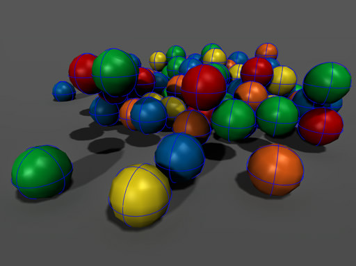

A sphere is the simplest and the fastest shape, as it has only one parameter: a radius. Continuous collision detection is available for spherical shapes. Therefore, passing through other objects even when moving at a high speed is avoided. 球形状是最简单,最快的形状,因为它只有一个参数:半径。连续碰撞检测可用于球形。因此,即使在高速移动时也避免穿过其他物体。
Using the spherical shape for any arbitrary mesh ensures that its collisions will always be detected.将球形用于任何任意网格可确保始终检测到其碰撞。
球形状
For a shape to fit your object, you can adjust the Radius of the sphere.要使形状适合您的对象,可以调整球体的 Radius
球面半径

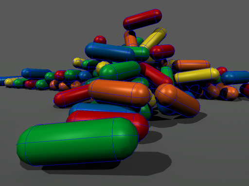

A capsule is also a very fast collision shape with continuous collision detection available. Capsules are convenient for approximation of elongated objects (pillars, etc.) as well as humanoid characters, because it allows them to go up and down the stairs smoothly, without stumbling at each step (if the steps are not too high). It also ensures that character's limb will not get stuck somewhere unexpectedly. 胶囊也是一种非常快速的检测碰撞形状,具有连续碰撞检测功能。胶囊便于拉长物体(支柱等)和类人动物角色,因为它使它们可以平稳地上下楼梯,而不会在每个步骤中绊脚(如果步骤不太高)。它还可以确保角色的肢体不会意外卡在某处。
胶囊的形状
For a shape to fit your object, you can adjust the Radius and the Height of the capsule.要使形状适合您的对象,您可以调整胶囊的半径高度

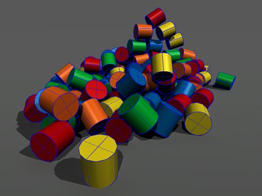

A cylinder can be used to approximate elongated shapes with flat ends (e.g. a shafts, pylons, etc.). It is similar to a box shape. 圆柱可用于近似具有平坦端部的细长形状(例如,杆,塔等)。类似于立方形状。
圆柱的形状
For a shape to fit your object, you can adjust the Radius and the Height of the cylinder.要使形状适合您的对象,可以调整圆柱的半径高度

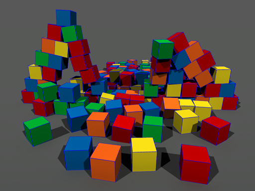

A box is a cuboid shape which can be used for approximation of volume of various objects. it is suitable for walls, doors, stairs, parts of mechanisms, car bodies, and many other things. The length of a box shape in each dimension can be chosen arbitrarily. 立方是一个长方体形状,可用于近似各种对象的体积。它适用于墙壁,门,楼梯,机械零件,车身以及许多其他物体。每个尺寸的立方形状的长度都可以任意选择。
For a shape to fit your object, you can adjust the size of the box along each axis: Size X, Size Y, Size Y.为使形状适合您的对象,您可以沿每个轴调整框的大小:Size X, Size Y, Size Y

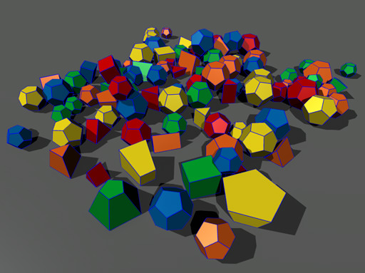

Convex hull is the slowest of all shapes and is used for objects having complex geometry. The created shape will always be convex, that is, holes and cavities of the mesh are ignored when generating a convex hull. Instead, they are included into the shape volume. Convex shape is the smallest shape that can enclose vertices of the approximated mesh. Convex hull是所有形状中最慢的,用于具有复杂几何形状的对象。创建的形状将始终是凸形的,即,在生成凸包时,将忽略网格的孔和腔。而是将它们包含在形状体积中。凸形是可以包围近似网格顶点的最小形状。
