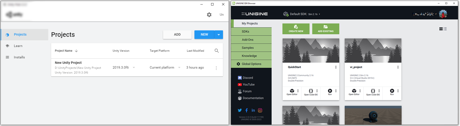

Project and SDK Management
项目和SDK管理#
As a Unity software user, you are accustomed to use Unity Hub — the application that streamlines the way you find, download and manage your projects and installations.作为Unity软件用户,您习惯于使用Unity Hub,该应用程序可简化查找,下载和管理项目及安装方式的方式。
UNIGINE SDK Browser is the first step to start working with UNIGINE Engine. This application enables you to manage your projects and installed SDKs, as well as gives you access to the samples and the knowledge base. UNIGINE SDK浏览器 是开始使用UNIGINE Engine的第一步。该应用程序使您可以管理项目和已安装的SDK,并可以访问示例和知识库。
Unity Hub和UNIGINE SDK浏览器比较 (点击放大)

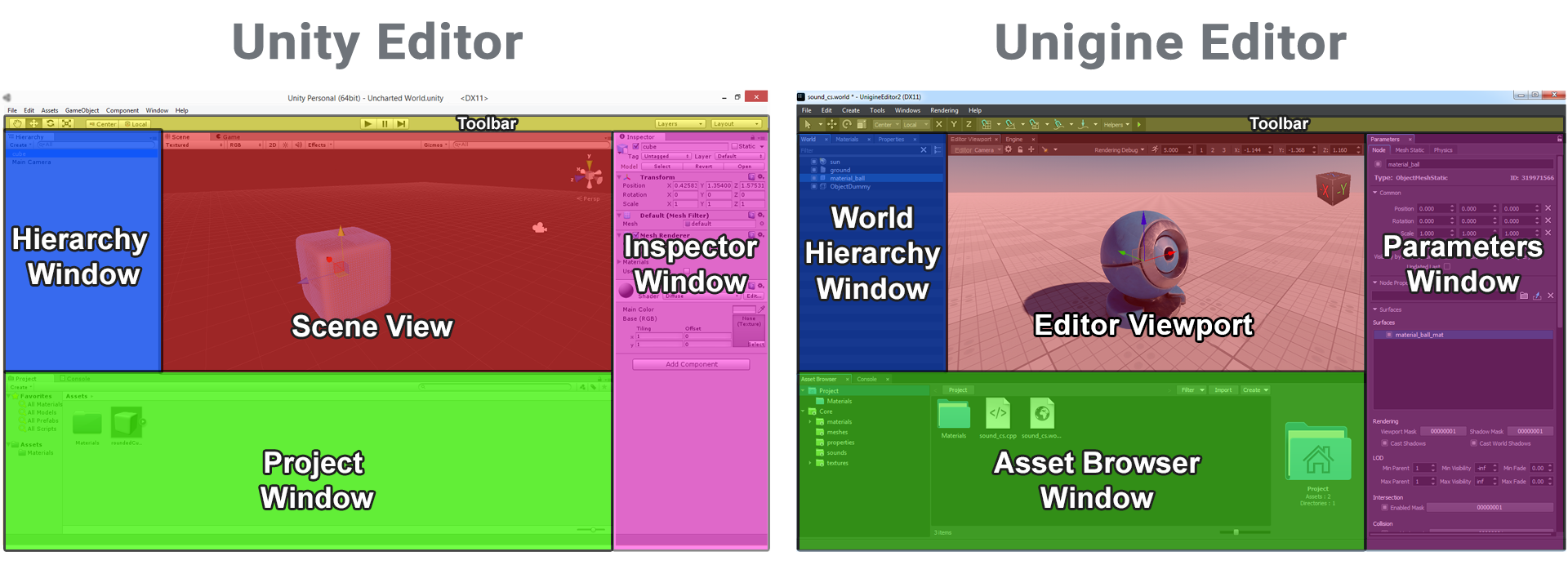

Editor Interface
编辑器界面#
Below you can see interfaces of Unity Editor and UnigineEditor. Interface elements in the images are color-coded to indicate common functionality. Each element has a label to show UNIGINE's equivalent. The layout of UnigineEditor is fully customizable by resizing, dragging and dropping the tabbed windows. UnigineEditor adopts a dark color scheme.在下面您可以看到Unity Editor和UnigineEditor的接口。图像中的界面元素采用颜色编码以指示常用功能。每个元素都有一个标签来显示UNIGINE的等效项。通过调整大小,拖放选项卡式窗口的大小,UnigineEditor的布局可以完全可自定义。 UnigineEditor采用深色方案。
Unity and UNIGINE Editor UI Comparison (click to enlarge)
Unity Editor and UnigineEditor UI ComparisonUnity编辑器和UnigineEditor UI比较
To learn more about the UnigineEditor interface, read this article.要了解有关UnigineEditor界面的更多信息,请阅读本文

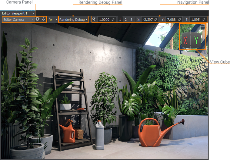

Scene View
场景检视#

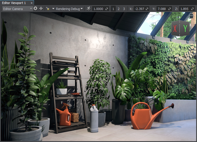

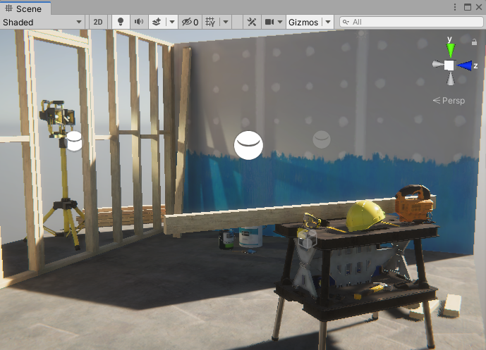

You may find the Scene View and the Editor Viewport controls looking very much alike.您可能会发现Scene ViewEditor Viewport控件看起来非常相似。
Unity Scene View
UNIGINE Editor Viewport
You can use:您可以使用:

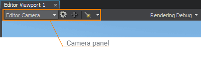

  • Camera panel to switch between cameras and configure the current one.Camera panel可以在摄像机之间切换并配置当前摄像机。

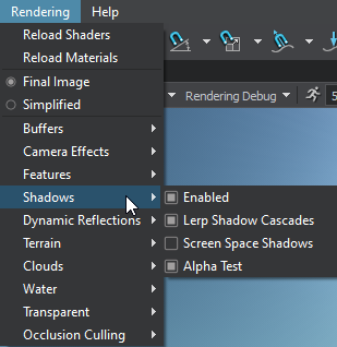

  • Rendering Debug to display the contents of rendering buffers the same way as using the Draw Mode in Unity Editor.Rendering Debug显示渲染缓冲区的内容,与在Unity Editor中使用Draw Mode相同。
  • Navigation panel to quickly set up and switch between camera speed presets and change the camera position.Navigation panel可快速设置并在摄像机速度预设之间切换并更改摄像机位置。
Navigation inside the Editor Viewport is pretty much the same as in Unity Scene View. However, get familiar with Scene Navigation so as not to miss details.Editor Viewport中的导航Unity Scene View中的几乎相同。但是,请熟悉场景导航,以免丢失细节。
Also, a set of global switchers is available in the top toolbar:另外,顶部的工具栏提供了一组全局切换器:
You can use as many Editor Viewports as you need.您可以根据需要将许多编辑器视口用作

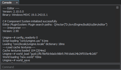

Console
安慰#
As well as Unity software, UNIGINE has the Console used for standard input, output and error logging. A set of console commands is provided.Unity软件外,UNIGINE还具有用于标准输入,输出和错误记录的控制台。提供了一组控制台命令
It is available both in UnigineEditor and a running application. To open the Console window in the Editor, go to Windows -> Console menu:它在UnigineEditor和正在运行的应用程序中均可用。要在编辑器中打开控制台窗口,请转到Windows -> Console菜单:
A built-in console is called by pressing the F1 key:按下grave accent (`)键可以调用内置控制台:
You can use it to print user messages from code.您可以使用它从代码中打印用户消息

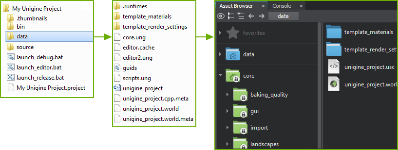

A project in UNIGINE, just like a Unity project, is stored in its own folder, project settings are stored in the *.project file. There are various subfolders inside the project's folder, where your content and source files as well as various configuration files and binaries are stored. The most important are the data and source sub-folders.就像Unity项目一样,UNIGINE中的项目存储在其自己的文件夹中,项目设置存储在*.project文件中。项目文件夹中有多个子文件夹,其中存储了内容和源文件以及各种配置文件和二进制文件。最重要的是数据来源子文件夹。
In UNIGINE, each project has a data folder. Similar to a Unity project's Assets folder, this is where your project's assets are stored. To import assets into your project, simply drop files into your project's data directory and they will be automatically imported and appear in the Asset Browser. The assets in the editor will update automatically as you make changes to the files using an external program.在UNIGINE中,每个项目都有一个data文件夹。类似于Unity项目的Assets文件夹,这是项目资源的存储位置。要将资源导入项目,只需将文件拖放到项目的data目录中,它们就会被自动导入并显示在资源浏览器中。当您使用外部程序对文件进行更改时,编辑器中的资源将自动更新。
Relationship between the contents of the data folder in your project's root on your computer, and the Project folder in the Asset Browser window计算机上项目根目录中的data文件夹的内容与Asset Browser窗口中的Project文件夹之间的关系

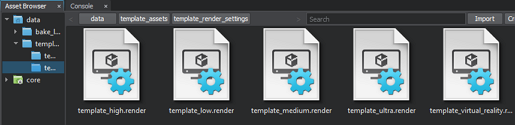

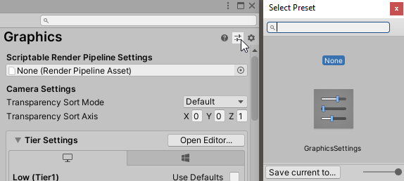

You use Presets in Unity Editor when you need to reuse property settings that have bearing to different tasks, be it component settings, import settings or especially Project Settings. You can save the settings preset for a certain section of the Project Settings as a .preset asset and reuse in development later.需要重新使用与不同任务相关的属性设置时,可以在Unity编辑器中使用“预设”,无论是组件设置,导入设置还是特别是项目设置。您可以将项目设置的某个部分的预设设置保存为.preset资源,并在以后的开发中重复使用。
Presets are an Editor-only feature in Unity software.预设是Unity软件中的仅编辑器功能。

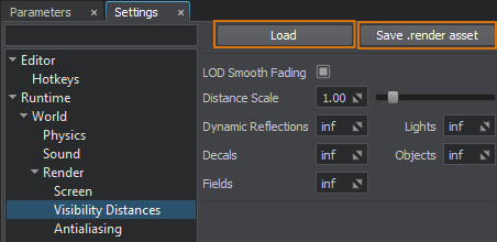

In UNIGINE, you can save and load presets for general physics, sound and render settings. The presets are stored as assets with the *.physics, *.sound and *.render extensions respectively. Use Load and Save .* asset buttons of the Settings window to work with presets of the corresponding settings section.在UNIGINE中,您可以保存和加载预设以进行常规的物理,声音和渲染设置。预设分别存储为资源,扩展名为*.physics*.sound*.render。使用Settings窗口的LoadSave .* asset按钮可使用相应设置部分的预设。
Saved assets appear in the Asset Browser. You can load the render settings by double-clicking the required .render asset.已保存的资源将显示在资源浏览器中。您可以通过双击所需的.render资源来加载渲染设置。
By default, a UNIGINE project provides settings for low, medium, high, ultra and virtual reality quality presets stored in the data/template_render_settings folder.默认情况下,UNIGINE项目为存储在data/template_render_settings文件夹中的low, medium, high, ultravirtual reality质量预设提供设置。
Presets are not an Editor-only feature in UNIGINE. You can use Physics, Sound and Render classes to manage presets for corresponding settings, for example, to switch between quality levels at run time.预设不是UNIGINE中的仅编辑器功能。您可以使用PhysicsSoundRender类管理相应设置的预设,例如,在运行时在质量级别之间切换。

  • The Graphics section contains global settings for graphics. The Tier Settings provide platform-specific adjustments to rendering and shader compilation. One of the three Tier levels to be applied is defined automatically based on the platform used. Graphics部分包含图形的全局设置。 Tier Settings为渲染和着色器编译提供特定于平台的调整。将根据所使用的平台自动定义要应用的三个层级之一。
  • The Quality section handles levels of graphical quality defined for each platform. Quality部分处理为每个平台定义的图形质量级别。
In UNIGINE, the rendering settings of the world can be found in the Render section of the Settings window. You can also toggle on and off the most common render features by using the Rendering menu:在UNIGINE中,可以在Settings窗口的Render部分中找到世界的渲染设置。您还可以使用Rendering菜单打开和关闭最常见的渲染功能:
There is no platform-dependent quiality adjustments in UNIGINE, you should write your own logic to control the quality levels. You can use Render Presets for this purpose.UNIGINE中没有依赖平台的质量调整,您应该编写自己的逻辑来控制质量水平。为此,您可以使用渲染预设
Let's consider the most commonly used rendering settings in Unity software and their corresponding analogs in UNIGINE:让我们考虑一下Unity软件中最常用的渲染设置及其在UNIGINE中对应的类似物:
Unity software UNIGINE
HDR Mode Render -> Buffers -> Color 16F
Rendering Path see below
Shaders Preloading shaders_preload console command
Pixel Light Count Forward Per-Object Limits
Texture Quality Render -> Textures -> Quality
Anisotropic Textures Render -> Textures -> Anisotropy
Anti Aliasing Render -> Antialiasing -> Supersampling
Soft Particles particles_base -> Soft Interaction
Realtime Reflection Probes Menu: Rendering -> Dynamic Reflections -> Enabled
Texture Streaming Render -> Streaming Settings
Shadows Render -> Shadows Settings
Shadow Cascades set per each World Light source
VSync Count Runtime -> Video settings
