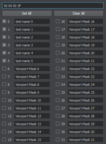

Surface viewport mask
Bit mask with the first bit turned on启用第一位的位掩码
  • Set All turns on all the bits in the mask Set All打开掩码中的所有位
  • Clear All turns off all the bits in the mask Clear All关闭掩码中的所有位

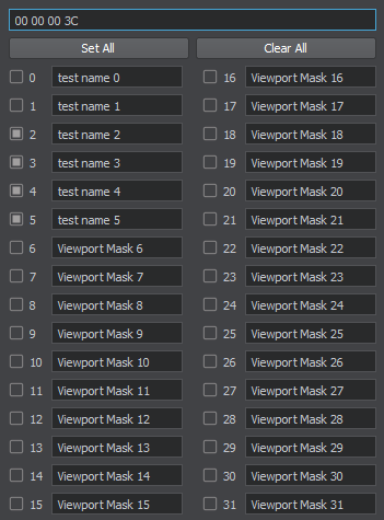

For example, the following viewport masks have 4 matching bits, so they match:例如,以下视口蒙版具有4个匹配位,因此它们匹配:
The camera Viewport mask with the first 6 bits enabled启用了前6位的相机Viewport掩码
The object's Viewport mask with the second, third, fourth, and fifth bits enabled启用了第二,第三,第四和第五位的对象的Viewport掩码

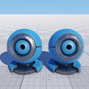

Suppose, we have two objects with the same material. To make one of them to be rendered into viewport and the other one — not to be rendered, we should change the Viewport mask of the second object.
In the surface Viewport masks of both objects, the same bit Viewport Mask 0 is enabled (00000001) In the surface Viewport masks of both objects, the same bit Viewport Mask 0 is enabled (00000001)
For the first object, all bits of the surface Viewport mask are disabled (the mask is set to 00000000)For the first object, all bits of the surface Viewport mask are disabled (the mask is set to 00000000)
In the surface Viewport masks of both objects, the same bit Viewport Mask 0 is enabled (00000001) For the first object, all bits of the surface Viewport mask are disabled (the mask is set to 00000000) 假設我們有兩個具有相同材質的對象。 為了使其中一個渲染到視口中,而另一個不渲染,我們應該更改第二個對象的Viewport mask
In the surface Viewport masks of both objects, the same bit Viewport Mask 0 is enabled (00000001) 在两个对象的表面Viewport蒙版中,启用了相同的位Viewport Mask 000000001
For the first object, all bits of the surface Viewport mask are disabled (the mask is set to 00000000)对于第一个对象,禁用了表面Viewport蒙版的所有位(该蒙版设置为00000000

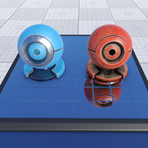

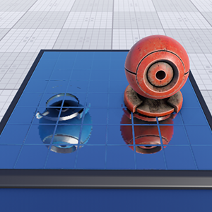

Suppose, you have a reflecting surface and two objects reflected in this surface.
  • To render an object without a reflection, either its Viewport mask or its material's Viewport mask should have no matching bits with the planar reflection's Viewport mask or the camera's reflection Viewport mask.To render an object without a reflection, either its Viewport mask or its material's Viewport mask should have no matching bits with the planar reflection's Viewport mask or the camera's reflection Viewport mask.
  • To render a reflection without an object, the object's Viewport mask or its material's Viewport mask should have no matching bits with the camera's Viewport mask.To render a reflection without an object, the object's Viewport mask or its material's Viewport mask should have no matching bits with the camera's Viewport mask.
To render an object without a reflection, either its Viewport mask or its material's Viewport mask should have no matching bits with the planar reflection's Viewport mask or the camera's reflection Viewport mask.To render a reflection without an object, the object's Viewport mask or its material's Viewport mask should have no matching bits with the camera's Viewport mask.假设您有一个反射表面,并且在该表面上反射了两个对象。
  • To render an object without a reflection, either its Viewport mask or its material's Viewport mask should have no matching bits with the planar reflection's Viewport mask or the camera's reflection Viewport mask.要渲染无反射的对象,其Viewport遮罩其材质的Viewport遮罩应与平面反射的Viewport遮罩相机的反射Viewport不具有匹配位。面具。
  • To render a reflection without an object, the object's Viewport mask or its material's Viewport mask should have no matching bits with the camera's Viewport mask.要在没有对象的情况下渲染反射,对象的Viewport遮罩其材质的Viewport遮罩应与相机的Viewport遮罩没有匹配的位。
In the example below, masks are given in the binary representation. For convenience, let's assume that objects and their materials have identical Viewport masks. For masks to match, they should share 1 in the appropriate bit position. You can convert these masks to the hexadecimal number representation and set the obtained values via UnigineEditor.在下面的示例中,掩码以二进制表示形式给出。为了方便起见,我们假设对象及其材质具有相同的Viewport蒙版。为了使掩码匹配,它们应在适当的位位置共享1。您可以将这些掩码转换为十六进制数字表示形式,并通过UnigineEditor设置获得的值。
An object without the reflection没有反射的对象
A reflection without the object没有对象的反射
蒙版
相機Viewport蒙版0111
相機Reflection Viewport蒙版1100
第一個對象的Viewport蒙版0001
第二個對象的Viewport蒙版0110
平面反射Viewport遮罩反射面材质的1110
蒙版
相機Viewport蒙版0111
第一個對象的Viewport蒙版1000
In the first example, the object's Viewport mask doesn't match the camera's reflection Viewport mask. However, it matches the camera's Viewport mask, so the object is rendered. 在第一个示例中,对象的Viewport遮罩与相机的反射Viewport遮罩不匹配。但是,它与摄影机的Viewport蒙版匹配,因此将渲染对象。
In the second example, the object's Viewport mask doesn't match the camera's Viewport mask. However, it matches the camera's Reflection Viewport mask and the planar reflection's Viewport mask, so the reflection is rendered. 在第二个示例中,对象的Viewport掩码与相机的Viewport掩码不匹配。但是,它与相机的Reflection Viewport遮罩相匹配,因此与平面反射的Viewport遮罩匹配,因此将渲染反射。

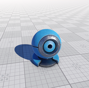

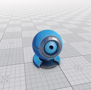

Usage Example
使用范例#

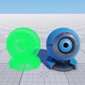

The example below demonstrates the difference. On the left, the Shadow masks of the surface and its material have all bits enabled, thus they have one bit matching the Shadow mask of the light source, and the shadow is rendered. On the right, the Shadow masks of the surface and its material don't match the Shadow mask of the light source, so the shadow isn't rendered.下面的示例演示了区别。在左侧,启用了表面及其材质的Shadow遮罩的所有位,因此它们具有与光源的Shadow遮罩相匹配的一位,并渲染了阴影。在右侧,表面的Shadow遮罩及其材质与光源的Shadow遮罩不匹配,因此不会渲染阴影。
Shadow mask of the surface and its material表面及其材质的Shadow蒙版
Shadow mask of the light source光源的Shadow蒙版

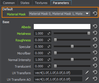

A Material mask is a 24-bit mask that specifies objects onto which the decal can be projected. An object or one of its surfaces can receive the decal only if the object's Material mask corresponds to the Material mask of the decal. Material遮罩是一个24位遮罩,用于指定可以在其上投影贴花的对象。仅当对象的Material蒙版与贴花的Material蒙版相对应时,对象或其表面之一才能接收贴花。
The Material mask can be specified for a selected material on the Parameters tab of the material editor:可以在材质编辑器的Parameters选项卡上为选定的材质指定Material蒙版:
Material mask field Material掩码字段
