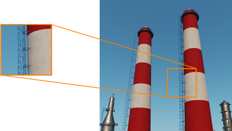

Subpixel Reconstruction Anti-Aliasing (SRAA) is an additional anti-aliasing technique that restores small image details. It also provides a net speedup and minimal overhead compared to supersampling. It is recommended to combine this technique with TAA for better anti-aliasing quality. Subpixel Reconstruction Anti-Aliasing (SRAA)是附加的抗锯齿技术,可还原较小的图像细节。与超级采样相比,它还提供了净加速和最小的开销。建议将此技术与 TAA 结合使用,以获得更好的抗锯齿质量。

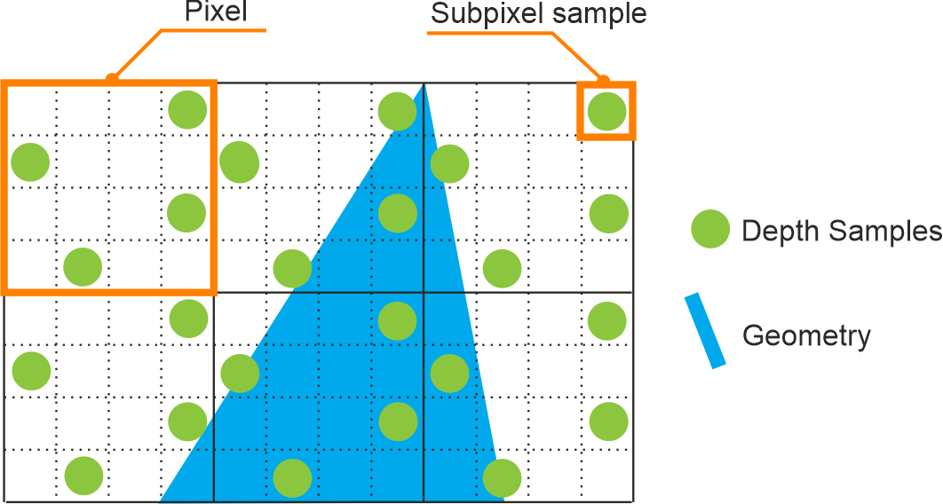

  1. Depth prepass multisampling generates depth position information at subpixel resolution. Subpixels are subdivision cells of a pixel. Depth prepass samples the geometry in the screen-space and stores samples’ position information in a G-buffer. 深度预通过多重采样以子像素分辨率生成深度位置信息。子像素是像素的细分单元。深度预通过对屏幕空间中的几何进行采样,并将采样的位置信息存储在G缓冲区中。

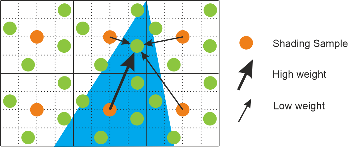

  2. Reconstruction pass uses the custom filter after the deferred shading to refine the shading results and output a screen-resolution, antialiased frame. In the picture below you can see how the SRAA reconstructs one subpixel. 延迟着色后的 重建过程使用自定义的 filter 来优化着色结果并输出屏幕分辨率的抗锯齿帧。在下面的图片中,您可以看到SRAA如何重建一个 subpixel
    At each geometric sample, all shaded neighbors in a fixed radius are considered and their values are interpolated using our custom filter with weights to restore subpixel details. A neighboring sample with significantly different depth is considered to be across a geometric edge (blue line), and receives a low weight. The filter weights estimate distance between source and target samples by comparing their depth values. 在每个几何样本中,均会考虑固定半径内所有阴影邻居,并使用我们的自定义滤镜对它们的值进行插值,以权重还原子像素细节。深度明显不同的相邻样本被认为是跨越几何边缘(蓝线),并且重量轻。过滤器权重通过比较源样本和目标样本的 depth 值来估计它们之间的距离。

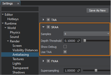

Subpixel Reconstruction Anti-Aliasing (SRAA) settings are available for adjustment via the Render -> Antialiasing section of the Settings window, along with Fast approXimate Anti-Aliasing (FXAA), Temporal Anti-Aliasing (TAA) and Supersampling settings. The following settings are available when the Custom preset for Anti-Aliasing is selected. Subpixel Reconstruction Anti-Aliasing (SRAA)设置可通过Settings窗口的Render -> Antialiasing部分以及快速近似抗锯齿(FXAA)临时抗锯齿(TAA)进行调整。和 Supersampling 设置。
SRAA Settings
Anti-Aliasing Settings抗锯齿设置
SRAA Settings
SRAA设置#
SRAA value indicating if Subpixel Reconstruction Anti-Aliasing (SRAA) is enabled. 默认.
通过控制台访问: render_sraa (API控制)
Samples number of depth geometry samples per pixel. This value may significantly affect performance, so keep it low when the image quality differences are not apparent. 以下值之一:
  • 2
  • 4 (默认)
  • 8
通过控制台访问: render_sraa_samples (API控制)
Depth Threshold depth threshold value used for edges detection that specifies the area for the SRAA processing. Turn on the debug mode and adjust this parameter in such a way that covers the required edges but at the same time leaves out the unnecessary geometry in the scene.
数值范围: [0.0f, inf]. 默认值为 : 0.1f.
通过控制台访问: render_sraa_depth_threshold (API控制)
Show Debug value indicating if the SRAA debug mode is enabled. This mode shows the geometry edges smoothed by the SRAA. 默认.
通过控制台访问: render_sraa_debug (API控制)
Use TAA value indicating if TAA integration is enabled. SRAA will use the shading sample from the previously rendered frame (TAA) to achieve correct anti-aliasing. Uses camera jittering, so it works only when the TAA (请参阅TAA) is enabled. It is recommended to use this option by default. 默认.
通过控制台访问: render_sraa_temporal (API控制)
