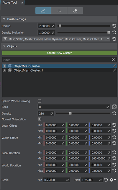

Switching to Cluster Paint Mode opens the Active Tool window:切换到此模式会打开 Active Tool 窗口:
In the Objects section, there is a list of all Mesh Cluster objects available in the world. Similarly to the World Hierarchy window, you can organize the nodes:Objects 部分,有一个世界上所有可用的 Mesh Cluster 对象的列表。与 World Hierarchy 窗口类似,您可以组织节点:
  • Select one or several nodes.选择一个或多个节点;
  • Toggle the nodes on and off.打开和关闭节点;
  • Filter nodes by name.按名称过滤节点;
  • Rename a node by double-clicking on it.通过双击重命名节点;
  • Toggle the Spawn When Drawing flag.切换 Spawn When Drawing 标志。
To edit the required Mesh Clusters (one or many), select them either in the Objects section or in the World Hierarchy window and specify the Objects settings.要编辑所需的 Mesh Clusters(一个或多个),请在 Objects 部分或 World Hierarchy 窗口中选择它们并指定对象设置.
For convenience, the Create New Cluster button, a shortcut to manual creation of Mesh Clusters, is available right in the Active Tool window.为方便起见, Create New Cluster 按钮,一个快捷方式手动创建 Mesh Clusters , 在 Active Tool 窗口中可用。

The following settings are saved for each Mesh Cluster in the scene:为场景中的每个 Mesh Cluster 保存以下设置:
Spawn When Drawing
Flag indicating if the Mesh Cluster is editable.
You should disable this flag to paint over the Mesh Cluster object.
指示 Mesh Cluster 是否受画笔绘制影响的标志。
Seed
Pseudo-random seed that defines the distribution of spawned meshes. Click the Randomize button to generate a new Seed.定义生成网格分布的伪随机种子。单击 Randomize 按钮生成一个新的 Seed
If the same Seed value is set for several Mesh Clusters, their new meshes will spawn at the same points during one stroke.如果为多个 Mesh Clusters 设置相同的 Seed 值,则它们的新网格将在一次笔划期间在相同点生成。
Density The target density of meshes of the Mesh Cluster.Mesh Cluster 的目标网格密度。
Normal Orientation Flag indicating whether new meshes should orient along the normals of surfaces under the brush.指示新网格是否应沿画笔下表面的法线定向的标志。
Local Offset Minimum and maximum offset values for new meshes with regard to normal orientation.新网格相对于法线方向的最小和最大偏移值。
World Offset Minimum and maximum offset for new meshes in world coordinates.世界坐标中新网格的最小和最大偏移。
Local Rotation Minimum and maximum rotation values for new meshes with regard to normal orientation.新网格相对于法线方向的最小和最大旋转值。
World Rotation Minimum and maximum rotation values for new meshes in world coordinates.世界坐标中新网格的最小和最大旋转值。
Scale
Minimum and maximum scale values for new meshes. Click the gear icon to choose the scale mode:新网格的最小和最大比例值。单击 齿轮图标以选择缩放模式:
  • Uniform — meshes are scaled uniformly along all axes.Uniform — 网格沿所有轴均匀缩放。
  • Nonuniform — scale is random along each axis.Nonuniform — 沿每个轴的比例是随机的。
