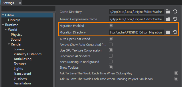

To toggle upgrading on and off and specify the migration folder, go to the Editor section of the Settings window:要打开和关闭升级并指定迁移文件夹,请转到Settings窗口的Editor部分:
The Migration Directory is a temporary folder for the outdated assets: they are copied into this folder and processed by the upgrade script. Then the upgraded assets replace the original ones.Migration Directory是过时资源的临时文件夹:它们被复制到这个文件夹中并由升级脚本处理。升级后的资源将替换原有资源。
