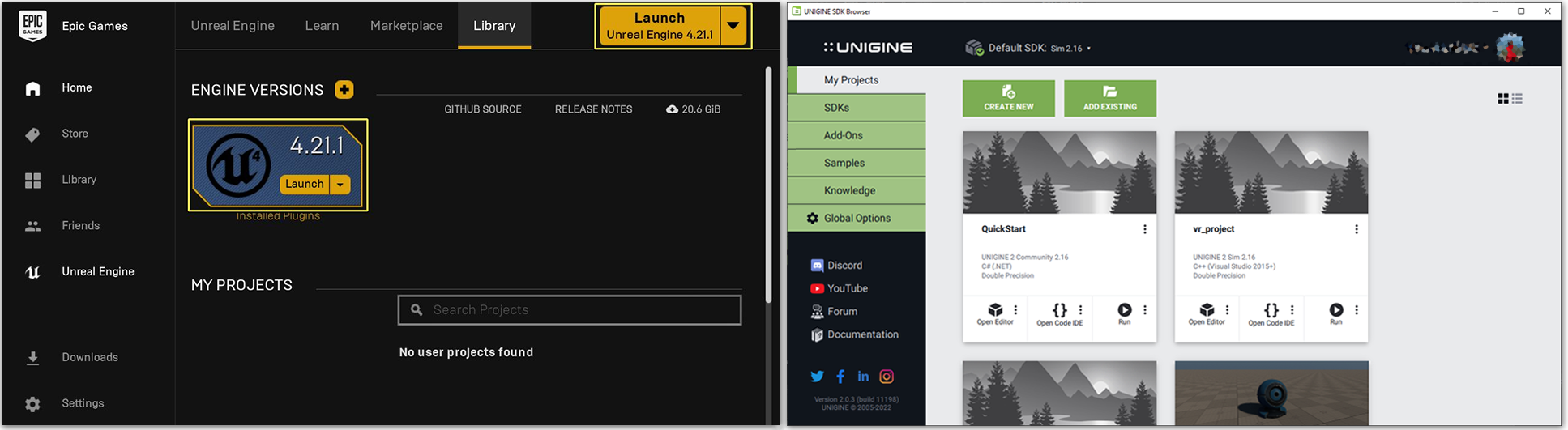

As an Unreal Engine user, you are accustomed to use Epic Games Launcher — the application that streamlines the way you find, download and manage your projects and installations. In addition to it, you can manage your projects directly via Unreal Editor: create a new project and switch between the existing ones.作为Unreal Engine用户,您习惯于使用Epic Games Launcher,该应用程序可简化查找,下载和管理项目及安装方式的方式。除此之外,您还可以直接通过Unreal Editor管理项目:创建一个新项目并在现有项目之间切换。
UNIGINE SDK Browser is the first step to start working with UNIGINE Engine. This application incorporates all project-related tasks and enables you to manage your projects and installed SDKs, as well as gives you access to the samples and the knowledge base.UNIGINE SDK Browser是开始使用UNIGINE Engine的第一步。该应用程序合并了所有与项目有关的任务,使您可以管理项目和已安装的SDK,还可以访问示例和知识库。
Epic Games Launcher and UNIGINE SDK Browser Comparison (click to enlarge)
Epic Games Launcher and UNIGINE SDK Browser ComparisonEpic Games Launcher和UNIGINE SDK浏览器比较

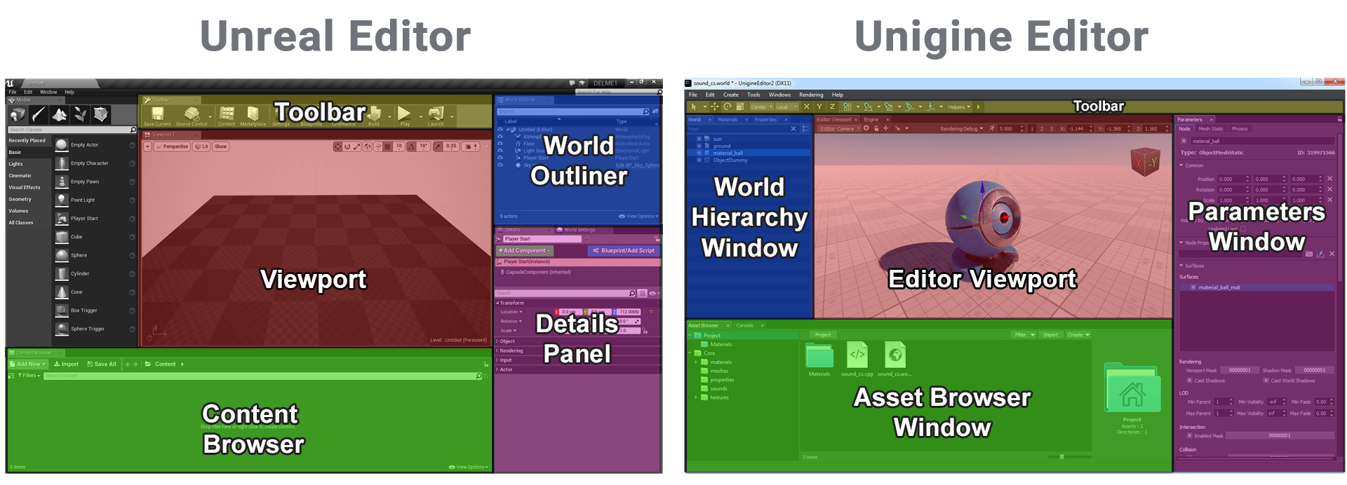

Below you can see interfaces of the Unreal Editor and UnigineEditor. Interface elements in the images are color-coded to indicate common functionality. Each element has a label to show UNIGINE's equivalent. The layout of UnigineEditor is fully customizable by resizing, dragging and dropping the tabbed windows.在下面,您可以看到Unreal EditorUnigineEditor的接口。图像中的界面元素采用颜色编码以指示常用功能。每个元素都有一个标签来显示UNIGINE的等效项。通过调整大小,拖放选项卡式窗口的大小,UnigineEditor的布局可以完全可自定义
Unreal and UNIGINE Editor UI Comparison (click to enlarge)
Unreal and UNIGINE Editor UI Comparison虚幻和UNIGINE编辑器的UI比较
To learn more about the UnigineEditor interface, read this article.要了解有关UnigineEditor界面的更多信息,请阅读本文

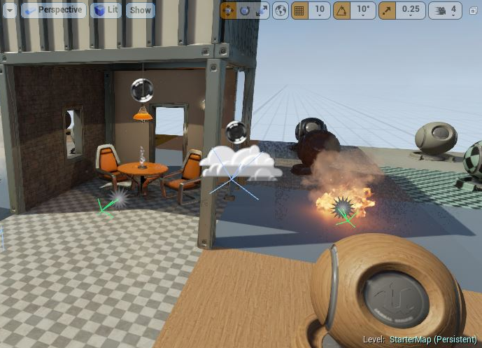

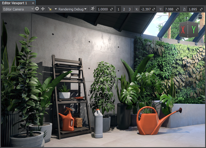

Unreal Editor Viewports and Editor Viewports in UnigineEditor are very much alike. You can use as many Editor Viewports as you need.UnigineEditor中的Unreal Editor ViewportsEditor Viewports非常相似。您可以根据需要将多个Editor视口用作
By default, an Editor Viewport renders its own Editor Camera view, and you can switch to another camera present in the scene and control it the same way as you pilot a CameraActor in UE.默认情况下,Editor视口会渲染其自己的Editor Camera视图,您可以切换到场景中存在的另一个摄像机,并以与在UE中导航CameraActor相同的方式对其进行控制。
Navigation inside Editor Viewports is pretty much the same as in UE Viewports. However, get familiar with Scene Navigation so as not to miss details.编辑器视口中的导航与UE视口中的导航几乎相同。但是,请熟悉场景导航,以免丢失细节。
UNIGINE Editor Viewport
You can use:您可以使用:

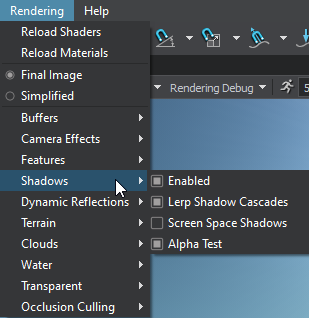

  • Camera panel to switch between cameras and configure the current one.Camera panel可以在摄像机之间切换并配置当前摄像机。
  • Rendering Debug to display the contents of rendering buffers the same way as using the Buffer Visualization Mode in UE4.Rendering Debug以显示渲染缓冲区的内容,与在UE4中使用Buffer Visualization Mode相同。
  • Navigation panel to quickly set up and switch between camera speed presets and change the camera position.Navigation panel可快速设置并在摄像机速度预设之间切换并更改摄像机位置。
  • ViewCube to switch between the perspective/orthographic projections and control orientation of the camera.ViewCube可以在透视 / 正投影投影和相机的控制方向之间切换。

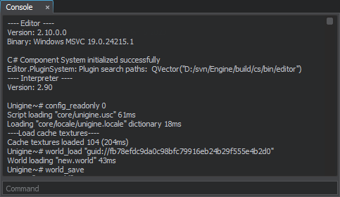

As well as UE4, UNIGINE has the Console used for standard input, output and error logging. A set of console commands is provided.与UE4一样,UNIGINE的控制台也用于标准输入,输出和错误记录。提供了一组控制台命令
It is available both in UnigineEditor and a running application. To open the Console window in the Editor, go to Windows -> Console menu:它在UnigineEditor和正在运行的应用程序中均可用。要在编辑器中打开控制台窗口,请转到Windows -> Console菜单:
A built-in console is called by pressing the F1 key:按下grave accent (`)键可以调用内置控制台:
You can use it to print user messages from code.您可以使用它从代码中打印用户消息

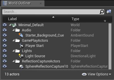

World Outliner世界大纲
Basic scene object — Actor.基本场景对象-Actor
It is the base object that can be placed in or spawned into the world.它是可以放置或生成到世界中的基础对象。
Actors can be organized into a hierarchy (parent-child relation).可以将演员组织成一个层次结构(父子关系)。
Actor is a container for Components that define its functionality.ActorComponents的容器,用于定义其功能。

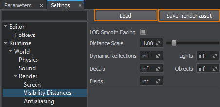

You use Export and Import buttons in the project settings of the Unreal Editor to save the values of the settings to an external configuration file (.ini) and load them when necessary.您可以在Unreal Editor的项目设置中使用导出导入按钮将设置的值保存到外部配置文件(.ini)中,并在必要时加载它们。
In UNIGINE, you can save and load general physics, sound and render settings the same way. The presets are stored as assets with the *.physics, *.sound and *.render extensions respectively. Use Load and Save .* asset buttons of the Settings window to work with presets of the corresponding settings section.在UNIGINE中,您可以保存和加载一般物理,声音和渲染设置。预设分别存储为资源,扩展名为*.physics*.sound*.render。使用Settings窗口的LoadSave .* asset按钮可使用相应设置部分的预设。
Saved assets appear in the Asset Browser. You can load the render settings by double-clicking the required .render asset.已保存的资源将显示在资源浏览器中。您可以通过双击所需的.render资源来加载渲染设置。
By default, a UNIGINE project provides settings for low, medium, high, ultra and virtual reality quality presets stored in the data/template_render_settings folder.默认情况下,UNIGINE项目为存储在data/template_render_settings文件夹中的low, medium, high, ultravirtual reality质量预设提供设置。
Presets are not an Editor-only feature in UNIGINE. You can use Physics, Sound and Render classes to manage presets for corresponding settings, for example, to switch between quality levels at run time.预设不是UNIGINE中的仅编辑器功能。您可以使用 物理 声音 渲染 类来管理对应设置的预设,例如,在运行时在质量级别之间切换。

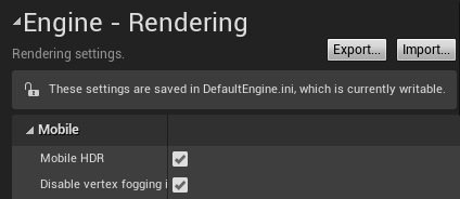

In UE4, settings for graphics quality are mostly gathered in the Engine - Rendering section.在UE4中,图形质量的设置大部分收集在Engine - Rendering部分中。
In UNIGINE, the rendering settings of the world can be found in the Render section of the Settings window. You can also toggle on and off the most common render features by using the Rendering menu:在UNIGINE中,世界的渲染设置可以在Settings窗口的Render部分中找到。您还可以使用Rendering菜单打开和关闭最常见的渲染功能:
There is no platform-dependent quiality adjustments in UNIGINE, you should write your own logic to control the quality levels. You can use Render Presets for this purpose.UNIGINE中没有依赖平台的质量调整,您应该编写自己的逻辑来控制质量水平。为此,您可以使用渲染预设

By default, Unreal Engine uses a Deferred Renderer. You can switch to Forward Shading Renderer, which would provide better performance in some cases, in the Project Setting -> Rendering section.默认情况下,Unreal Engine使用延迟渲染器。您可以在Project Setting -> Rendering部分中切换到 Forward Shading Renderer ,在某些情况下可以提供更好的性能。
UNIGINE has the fixed Rendering Sequence represented by a combination of a full deferred renderer with forward rendering techniques:UNIGINE具有固定的 Rendering Sequence (固定序列),由完整的延迟渲染器与正向渲染技术的组合表示:
  • All opaque (non-transparent) geometry is rendered in the deferred pass.所有不透明(非透明)几何图形均在延迟的过程中呈现。
  • Transparent geometry is rendered in the forward pass.透明几何图形在正向传递中呈现。
You can reduce computational load by skipping certain rendering stages. Watch the dedicated video tutorial on using the Microprofile tool to optimize rendering:您可以通过跳过某些渲染阶段来减少计算量。观看有关使用Microprofile工具优化渲染的视频教程:
