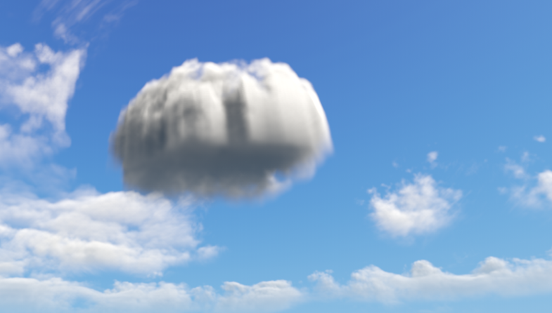

A Field Weather is an object that specifies location of local cloud coverage areas within cloud layers. The FieldWeather object allows creating local storms or clouds that have their own coverage texture as well as to control their movement. The number of FieldWeather objects in the scene is not limited as their impact on performance is not significant.
A Field Weather coverage is visible only when the camera is within the dynamic coverage area, which can be set up via the Settings window.
A FieldWeather object will affect clouds only if the Field mask matches the Field Weather mask of the clouds_base material.
Local stormcloud created by using a Field Weather object

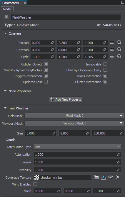

  3. Go to the Node tab of the Parameters window, and set up necessary parameters.
Setting Up Field Weather#
In the Field Weather section (Parameters window -> Node tab), the following parameters of the Field Weather object can be adjusted:
Setting Bit Masks and Size#
Field Mask A field mask. The Field Weather object is applied to a cloud layer only if they have matching masks.
Viewport Mask A Viewport mask. A bit mask for rendering the Field Weather object into the current viewport. For the Field Weather object to be rendered into the viewport, its mask should match the camera Viewport mask.
Size Size of the Field Weather object along the axes in units.

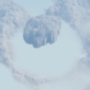

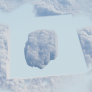

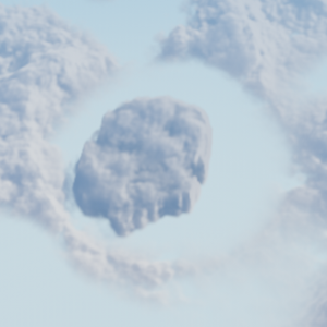

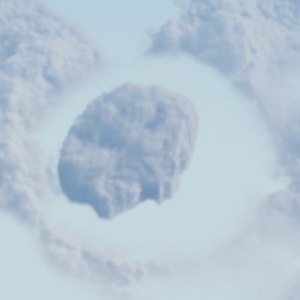

Attenuation Type Type of attenuation shape. This parameters determines the way the local clouds of the Field Weather object are mixed with the surrounding clouds. Can be one of the following:
  • Sphere
  • Box
Attenuation type = Sphere
Attenuation type = Box

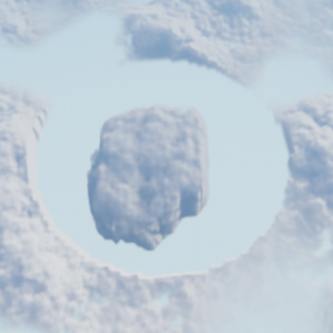

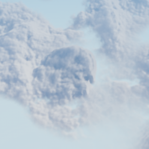

Attenuation Attenuation factor indicating how much the coverage texture attenuates starting from the center of the Field Weather object to its edges.
  • By the minimum value of 0, only local coverage texture of the Field Weather object is visible (the coverage texture of the CloudLayer is totally cut out from the Field Weather area).
  • The higher the value, the less surrounding clouds (CloudLayer coverage) are cut out from the Field Weather area.
Attenuation = 0.5
Attenuation = 1.5
