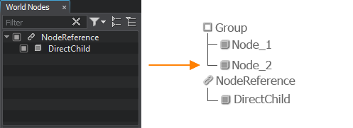

Automatic Unpacking Disabled#
If auto-unpacking is disabled (by default in C++ / UnigineScript only projects), the content of NodeReference nodes is added to the root of the world nodes hierarchy and can be accessed only as references.
Automatic Unpacking is disabled.
#include <UnigineNodes.h>
int AppWorldLogic::init()
	// create a NodeReference instance
	NodeReferencePtr nodeRef = NodeReference::create("unigine_project/nodes/node_reference_0.node");
	// get the reference node
	NodePtr group = nodeRef->getReference();
	// find the desired node
	NodePtr node_2 = group->getChild(group->findChild("Node_2"));

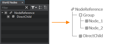

Automatic Unpacking Enabled#
When automatic unpacking of NodeReference is enabled (by default in C# projects), the content of NodeReference nodes is extracted to simplify hierarchy management. It is done only at run time and does not affect your *.world and *.node files.
Automatic Unpacking is enabled.
The heirarchy of NodeReference's contents is attached to it as an immediate child, so you can access it in a straightforward manner:
	NodeReferencePtr nodeRef = NodeReference::create("nodes/node_reference_0.node");
	// get the root node of the pre-fabricated hierarchy
	NodePtr group = nodeRef->getChild(0);
	// find the desired node among all descendants
	NodePtr node_2 = nodeRef->findNode("Node_2", 1);
