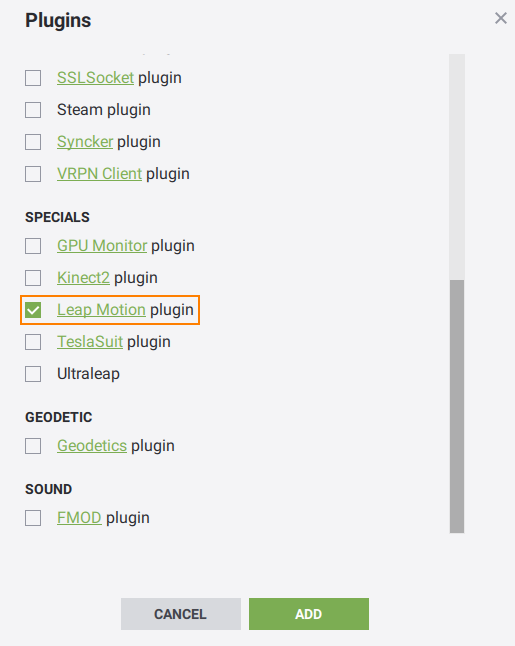

  2. Create a new project with LeapMotion support via UNIGINE SDK Browser: click Plugins, check the LeapMotion support (LeapMotion plugin) option in the form that opens and click OK.通过 UNIGINE SDK 浏览器创建一个支持 LeapMotion 的新项目:单击 Plugins,在打开的表单中选中 LeapMotion support (LeapMotion plugin) 选项,然后单击 OK
    LeapMotion Plugin on Plugins PanelPlugins 面板上的 LeapMotion 插件
    To add LeapMotion support to the existing project, in UNIGINE SDK Browser, click Other Actions -> Configure Project -> Plugins -> LeapMotion support (LeapMotion plugin) -> OK. 要将 LeapMotion 支持添加到现有项目,请在 UNIGINE SDK Browser 中单击 Other Actions -> Configure Project -> Plugins -> LeapMotion support (LeapMotion plugin) -> OK
