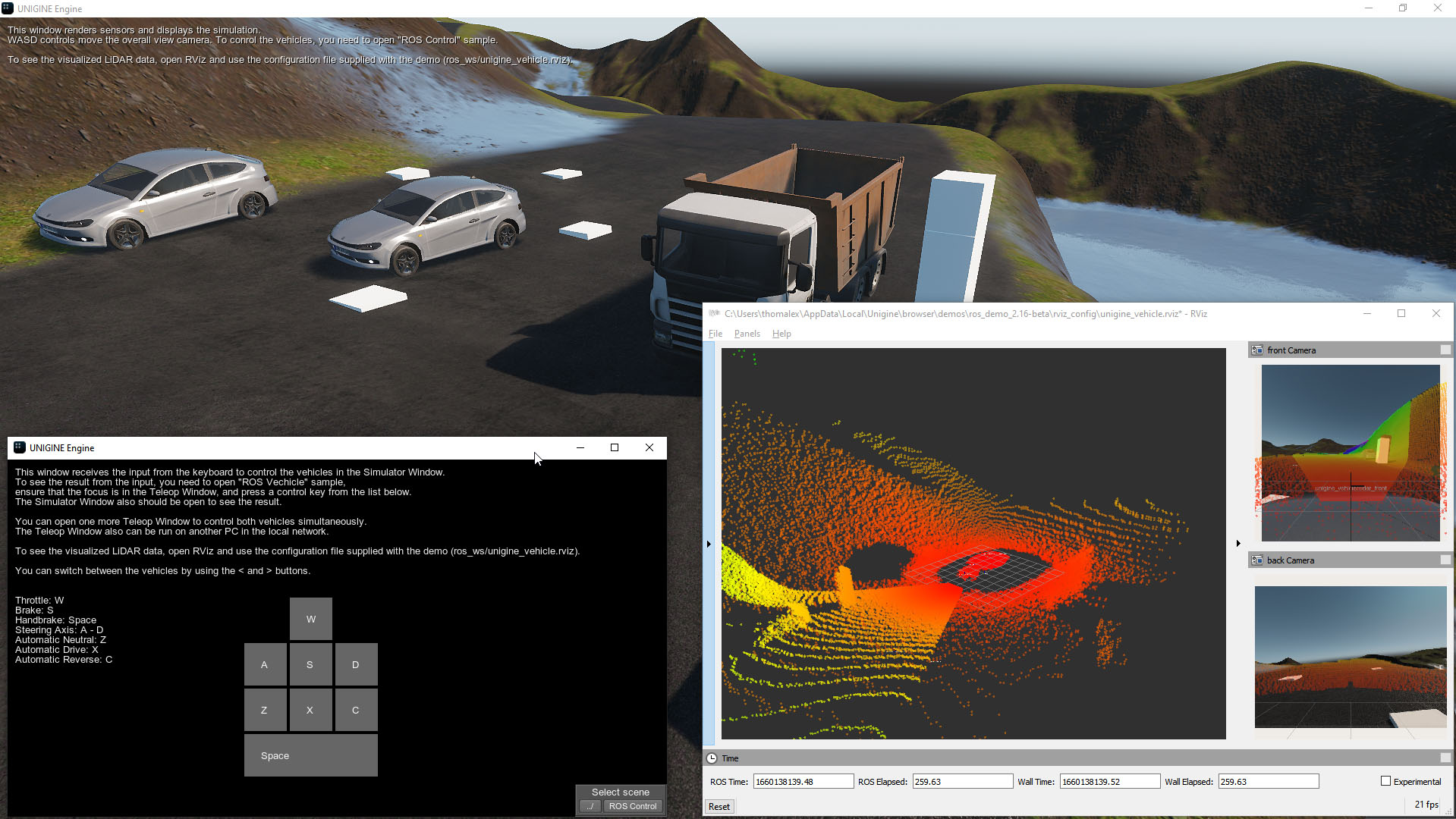

This demo is based on ROS2 Galactic and showcases integration of the Robot Operating System (ROS 2) with a UNIGINE project to help build robot applications. The demo implements simulation of the automotive vehicle control via ROS and simulation of sensors (cameras and LiDARs) mounted on the car. In the application, you can control two vehicles available in the demo scene. The data from cameras and LiDARs can be sent via ROS to any other listening app.
The ROS Vehicle project can't be built in Visual Studio or CMake. Use this instruction to build the project.
Features#
This demo requires at least two modules (ROS nodes) to be run simultaneously:
  • ROS Vehicle (Simulator) — renders the simulation and sensor data that can be sent via ROS to any other listening app and simulates physics (UNIGINE can also be used as Image Generator with physics and vehicle model calculated on separate nodes). Use WASD controls + mouse to move the overall view camera. To control the vehicles, use Teleop applications, the Simulator shall receive user input and move vehicles accordingly.
  • ROS Control (Teleop) — processes the input (control keys pressed) from the user and transmits it to other ROS nodes. To control two vehicles simultaneously, you can run two Teleop applications on the same PC or on different PCs in the local network. Another control application (e.g. your own implementation of control system of an autonomous vehicle) can be used instead of Teleop to control vehicles in the Simulator.
The Simulator application sends data from cameras and LiDARs to RViz 3D visualization tool for ROS (included in the original ROS2 package) that renders point cloud visualization based on the sensor data received.
To launch RViz 3D application use the corresponding script depending on your OS: run_rviz2_linux.sh/run_rviz2_windows.bat.
