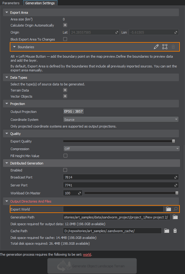

The Generation Settings panel is behind the Parameters panel and is accessible by switching the tabs.后面的Generation Settings面板Parameters面板,可以通过切换选项卡。
The items required to be set in order to start the terrain generation process, are highlighted red and displayed at the bottom.设置所需的物品为了启动地形生成过程,突出显示红色,底部显示。

By default, all imported data are used to generate a terrain. It might take some time depending on the scope of your data.默认情况下,所有进口数据用于生成地形。它可能需要一些时间取决于您的数据的范围。
You can set boundaries for the export area to limit the generated terrain area.你可以设定界限的出口区域生成的地形限制区域。
Export World
Export World#
Export World is a world where your terrain will be generated. If you have a world open in UNIGINE Editor, it would be set as the export world automatically. Otherwise, you'll need to (create and) select the world manually.Export World是一个世界,在那里你的地形将生成。如果你有一个世界开放UNIGINE Editor,它会被自动设置为出口世界。否则,您将需要手动选择世界。
