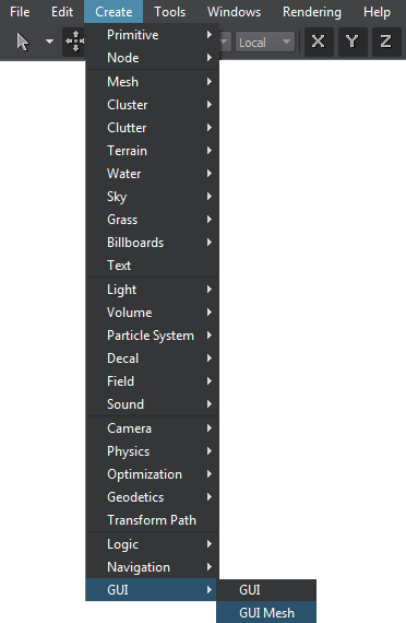

You can add a GUI Mesh via UnigineEditor and then assign a widget to it via UnigineScript.您可以通过UnigineEditor添加GUI Mesh,然后通过UnigineScript为它分配一个小部件。
To add the GUI Mesh:要添加GUI Mesh:
- Run the project with UnigineEditor.跑步UnigineEditor的项目。
On the Menu bar, click Create -> GUI -> GUI Mesh.在菜单栏上,单击Create -> GUI -> GUI Mesh。
- Specify a mesh on which the GUI will be rendered.指定将在其上呈现GUI的网格。
- Place the GUI Mesh in the world and specify the required parameters for it.将GUI Mesh放置在世界上,为其指定所需的参数。
- In the script, get the GUI object via the World.getNodeByName() (or World.getNodeByID() if you have the node index) and assign a widget to it by using functions of the ObjectGuiMesh class.在脚本中,通过World.getNodeByName()(或拥有节点索引的World.getNodeByID() if)获取GUI对象,并使用ObjectGuiMesh类的函数为其分配小部件。

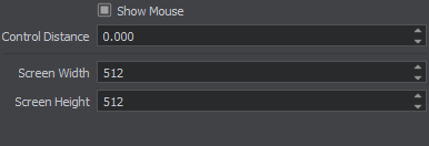

In the Gui Mesh section of the Node tab, you can adjust the following parameters of the GUI Mesh:在Node选项卡的Gui Mesh部分中,可以调整GUI Mesh的以下参数:
Show Mouse | Indicates if the mouse cursor should be rendered in the GUI Mesh.指示是否应在GUI Mesh中呈现鼠标光标。 |
Control Distance | Distance at which the GUI Mesh becomes controllable.GUI Mesh可控制的距离。 |
Screen Width | Width of the GUI object in pixels.GUI对象的宽度(以像素为单位)。 |
Screen Height | Height of the GUI object in pixels.GUI对象的高度(以像素为单位)。 |
