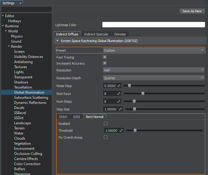

Customizable Settings#
Bent Normal custom settings
Bent Normal Settings
Enabled The value indicating if ray-traced bent normals calculation is enabled. The use of SSRTGI for bent normals allows for smooth ambient lighting.
Ray-traced bent normals calculation available only when the SSRTGI technique (see the SSRTGIPreset) is enabled.
by default.
Console access: render_bent_normal (API control)
Threshold The threshold value for the ray-traced bent normals calculation.
Ray-traced bent normals calculation is available only when the SSRTGI technique (see the SSRTGIPreset) is enabled.
Console access: render_bent_normal_threshold (API control)
Fix Overlit Areas The value indicating if correction of overlit areas for bent normals calculation is enabled.
  • This option may significantly affect performance, so disable it when it's not necessary.
  • Ray-traced bent normals calculation is available only when the SSRTGI technique (see the SSRTGIPreset) is enabled.
by default.
Console access: render_bent_normal_fix_overlit_areas (API control)
