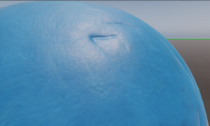

Original normal map Two maps

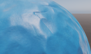

(Add node)
Two maps

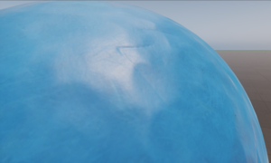

(Reorient Normal Blend node)
