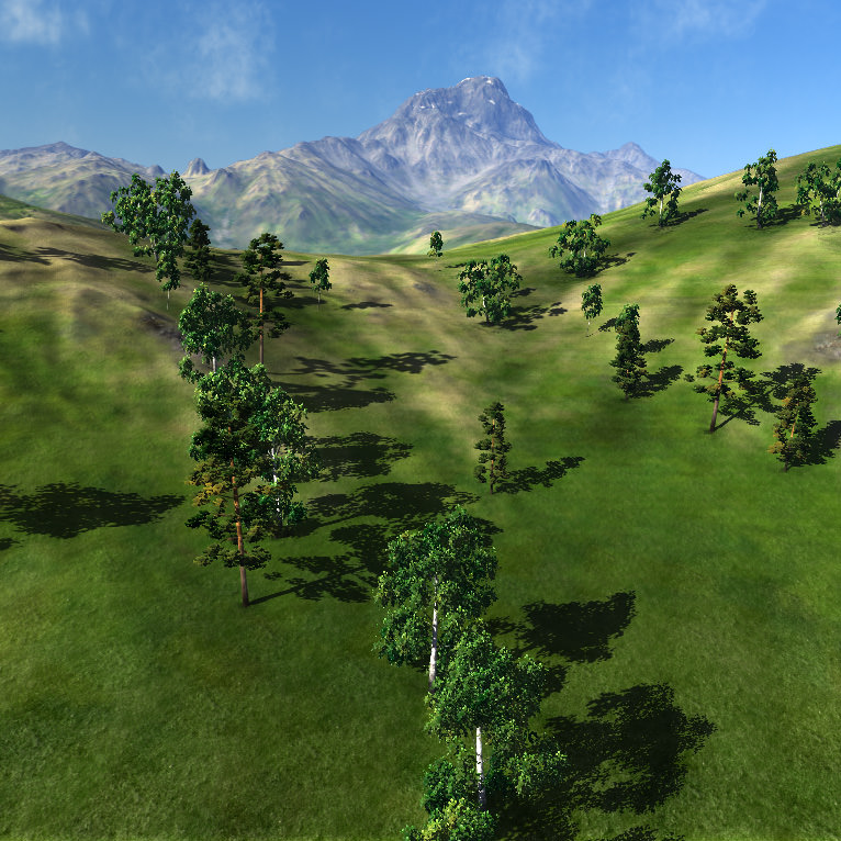

Mask Areas across which the nodes are randomly scattered and areas where there will be no nodes from the list. For example, on the terrain, the mask allows scattering stones across the rocky areas, while leaving the grassy ones free of rocks.
  • The mask is a 1-channelled texture (R8). If there are more channels in the provided mask, they will be ignored.
    • Zero color value specify the areas without cluster nodes.
    • The higher the color value is, the more nodes are presented in this area and the denser they are positioned.
    • Color value of 255 means the density value is defined by the corresponding parameter only.
  • Masking is done for all nodes that are contained in the world cluster list.
World Cluster mask for scattering
