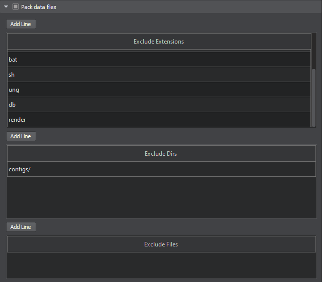

Encryption#
Project files can be encrypted using the UNIGINE-native UNG archive format. UNG files are transparent to the engine, and their content is handled as not packed. To save your files in UNG format, use the Archiver tool.

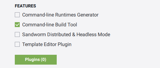

Console Build#
To simplify continuous integration (CI) and batch processing the Build Tool supports console-based management. In the console mode all build options (see descriptions above) can be configured via the dedicated file. By default the file has the following path: <data_path>.editor2/.assemblytool. Default values of configuration parameters are taken from this file (see the example below), but you can change them at your disposal. There are no specific requirements to the name and extension of this file, but it should be in JSON format.
