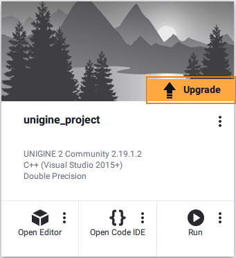

      If you're using UNIGINE SDK Sim, select the Engineering *.project file when importing the sample. After import, you can upgrade the project to the Sim version directly in SDK Browser - just click Upgrade, choose the SDK Sim version, and adjust any additional settings you want to use in the configuration window that opens.

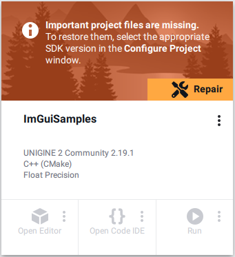

  4. Repair the project.
    • After importing, you'll see a Repair warning - this is expected, as only essential files are stored in the Git repository. SDK Browser will restore the rest.
    • Click Repair to let SDK Browser restore the required files.
    • When the configuration window opens, click Configure Project.
